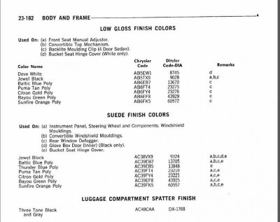

Meanwhile, this is in the 1970 Plymouth shop manual under the Satellite section -
