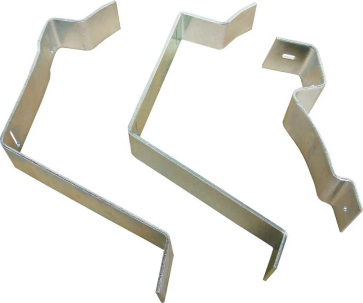

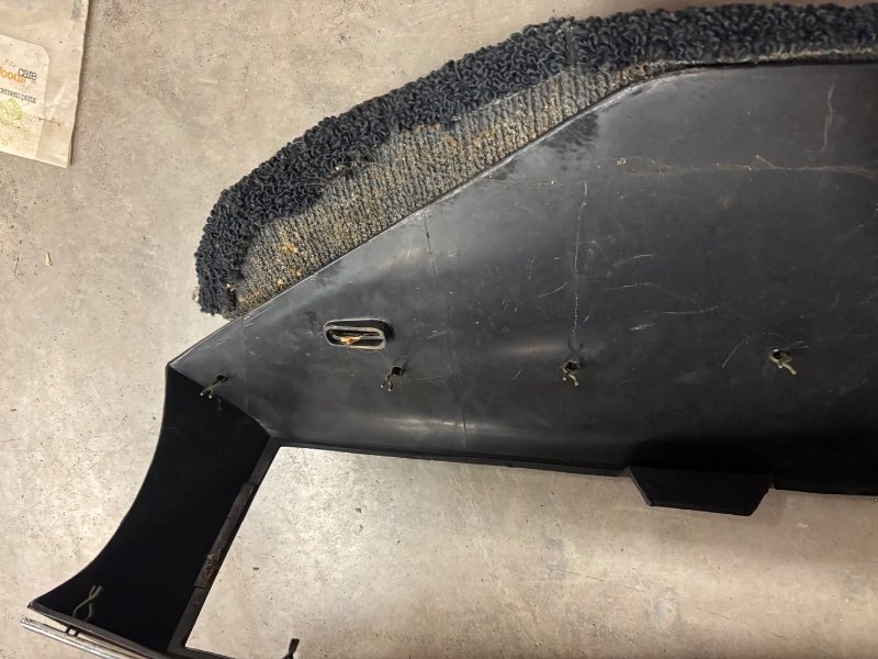

I am installing an automatic console in my 4 speed coronet. I purchased the standard top plate ,mounting brackets and 4 speed bulge plate for the shifter hump. I have a couple of questions. First,in the bulge side I purchased,theres a one inch hole that doesn't seem to match up with anything so wondering what its used for. Secondly,I repaled my dash harness with a new one from M&H and am wondering where I would plug the console lights into. These lights come on when the door opens.

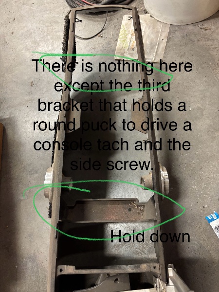

I'm converting the automatic console to be used for a 4 speed. That hole is just open and I have the floor bracket but nothing is there to attach to it

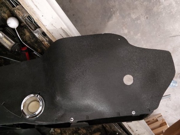

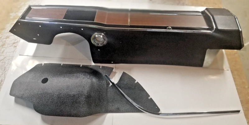

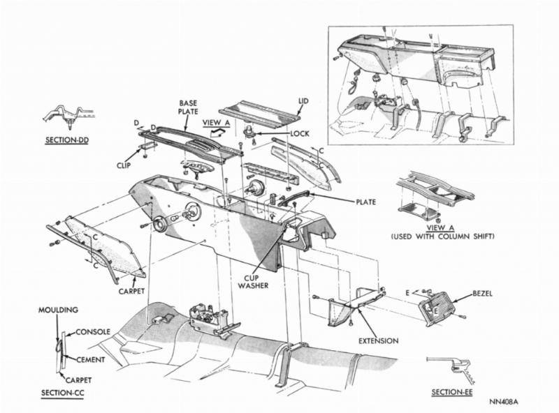

I could be wrong but i think that hole in the bulge plate is to access the bolt that fastens the main part of the console to the front console bracket. The photo below is an auto console but the manual console still attaches to the front bracket in the same area. The hole will be covered up by the 4 speed console carpet kit.
