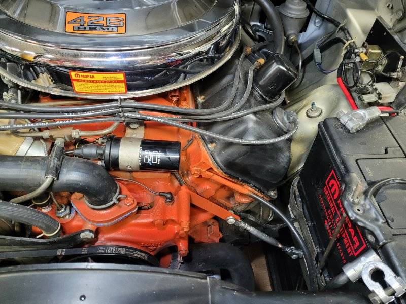

You can also install one of these that are motor mount savers. Well-made and easy to install.
Torque Straps
Aircraft turnbuckle and an eye bolt through the frame.
