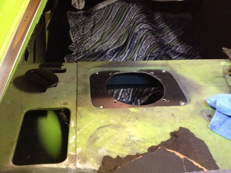

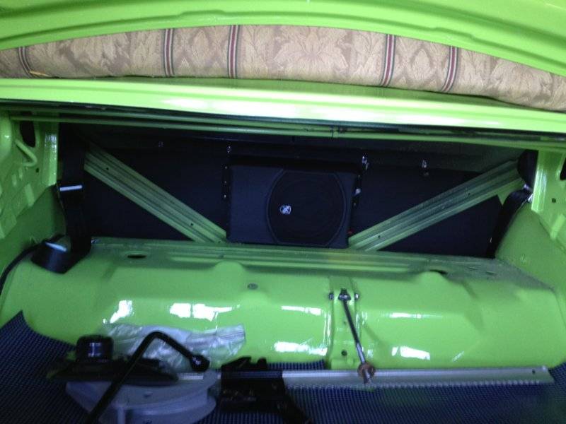

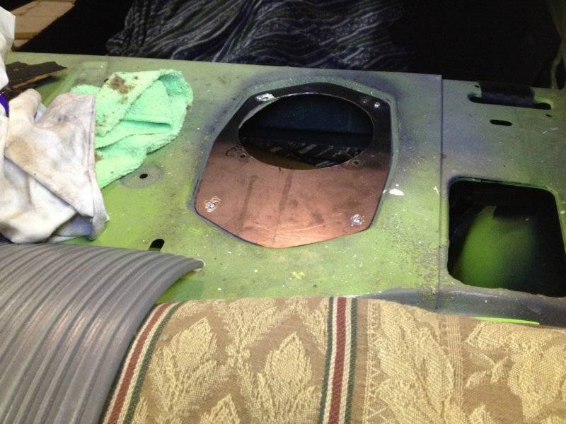

The two cutouts are oriented differently and are different sizes. You can get a 6x9 to fit the passenger side, but there are some fitment issues. I chose to install circular speakers and made small metal inserts so both speakers ended up being oriented the same. I like it much better (my symmetry need is satisfied). I also installed a subwofer behind the rear seat as well, and the combination works great.

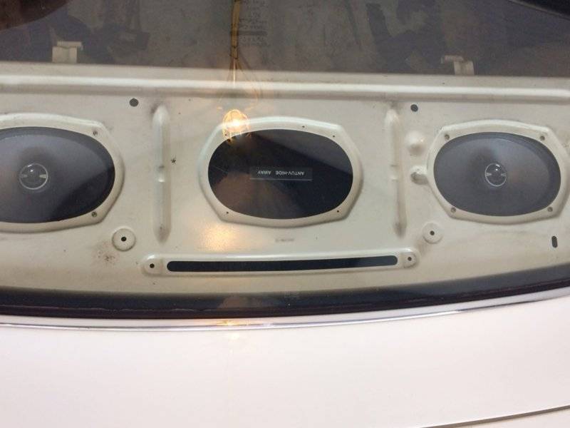

I did this on a 67 and 68. 6x9's are a direct fit. The defrost cutout is a long slot in the middle.
Different directions, but 6x9" on both works fine.

View attachment 659386 View attachment 659387 View attachment 659388

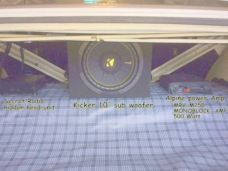

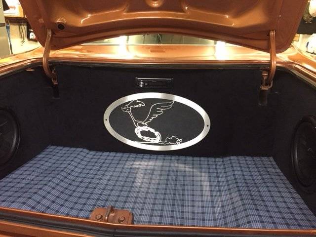

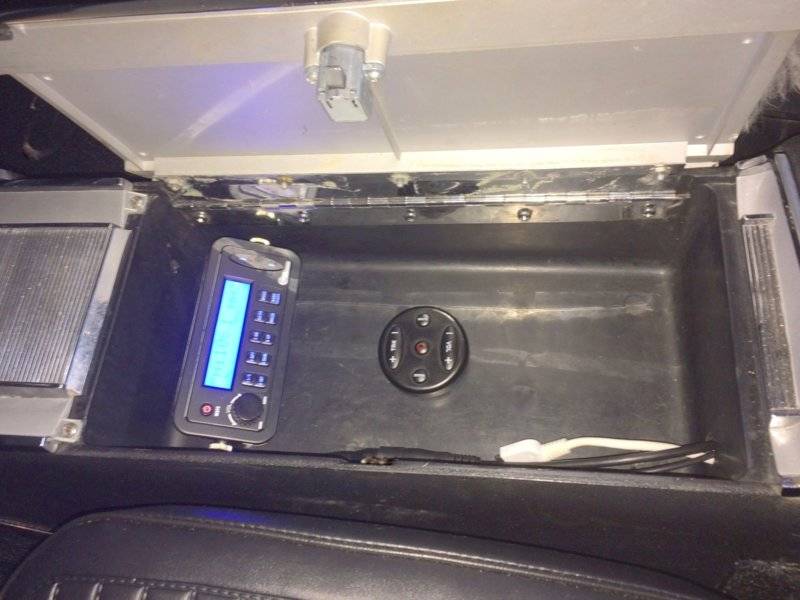

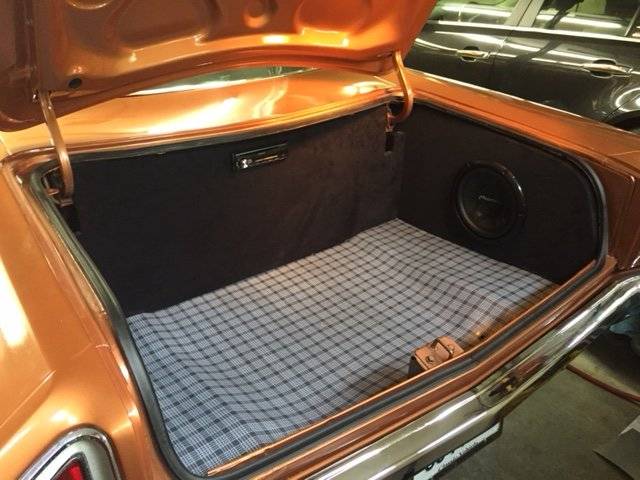

67 GTX, Went with Alpine three way 6x9" Kicker 10" sub, hidden FM stereo with remote with I- pod Docking, USB, still retain the factory Am radio and front dash speaker.
1000w amp,
