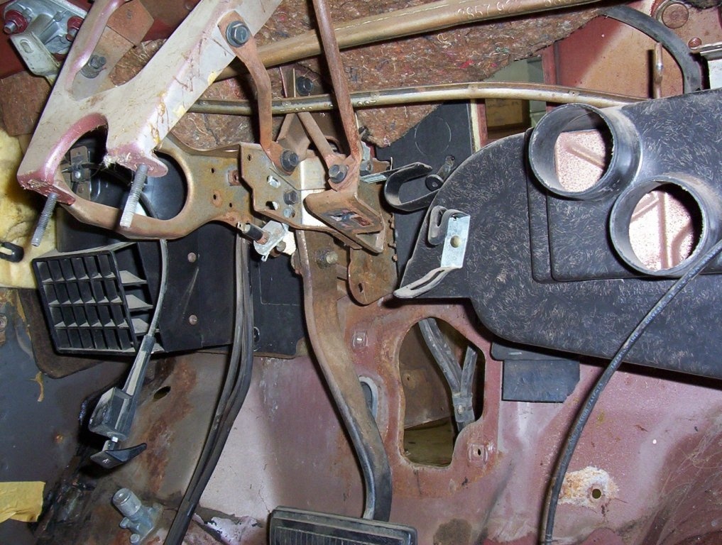

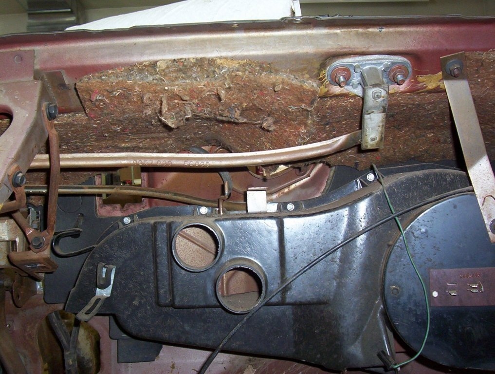

Hello. I was hoping their were some pictures or descriptions out there on how to install the two underdash wiper arms on my 1969 Road Runner. I didnt take enough pictures when I disassembled it 8 years ago! Same old story folks. I have learned my lesson. I would appreciate any help. Also, other than the arms themselves are their any other parts (bushings etc or speacial bolts) that are necessary for the install. Thanks for your help Wild Bill.
Here's the best I got. They are pretty self explanatory, the silver pieces that the wiper arms slip on to have an L or R on them telling you which side they are for. The other rod connects to the motor. There are seals that are required and you can get those from Detroit Muscle Technologies.
View attachment 340948 View attachment 340949
Eagleone 1983. Thanks so much for your response to my request for help! Yes, the pictures tell a thousand words! They should help. Thank you so much!

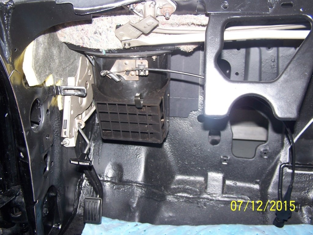

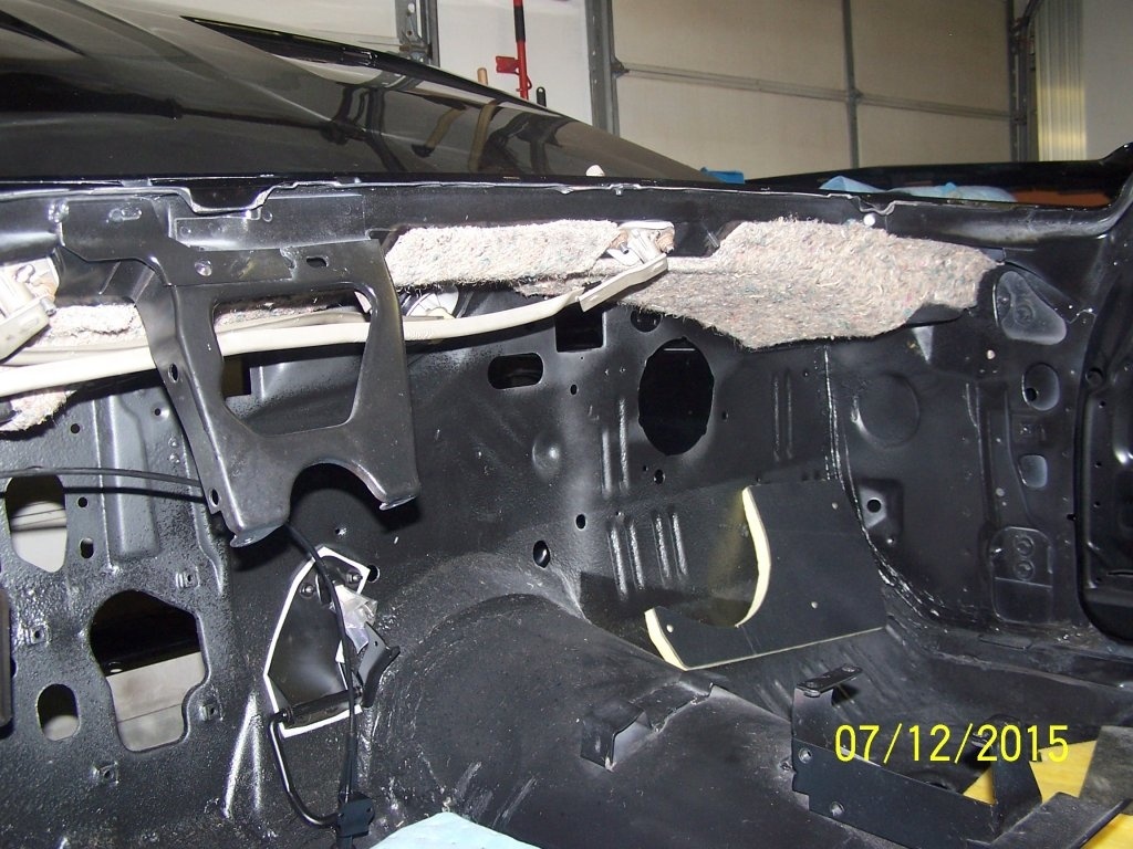

These help you any? I added a grease zirk to mine just to be able to get a bit more grease in them. They were pretty dry.
sixpactogo, really really ausome photos. they help tremendiously. I believe I know how to install now. Thank all you folks so much for helping! Wildbill
