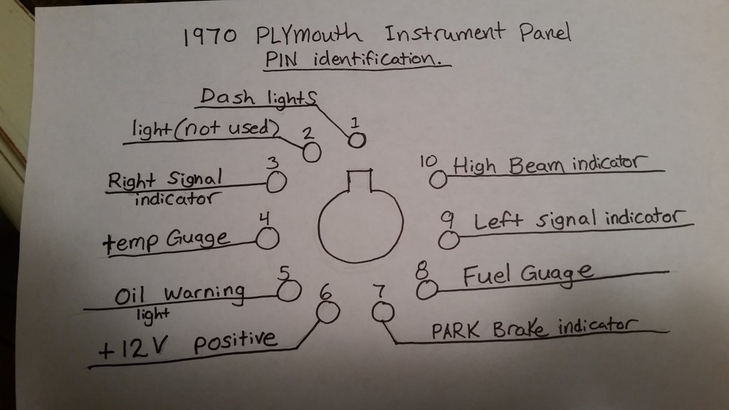

Instrument panel connection identification
KyleFinlay
3:05 AM
Nov 7, 2015
12
1
Idaho
I wanted to post this in case anyone has ever had trouble with their instrument panel, or in case anyone was to install a full aftermarket set of gauges and wanted to stick to the original wires if they are still in good shape. This was off of a 1970 satallite. The picture is based off of the back of the instrument panel, just reverse the order if your looking at the wiring harness inside the dash
