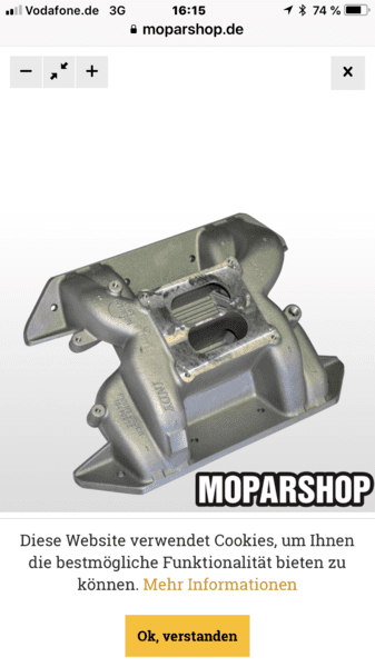

Looking stock , but less high than a Edelbrock performer , with a drop down airfilter base schould be work .
