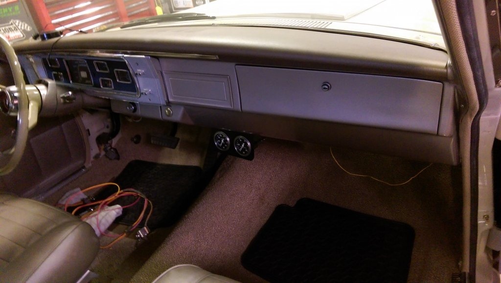

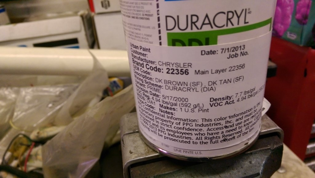

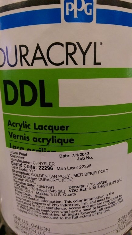

the interior paint is available through urban paint in Niagara falls NY I bought it there the correct upper color and it does have the correct texture also. the lower color is YY1 golden tan poly or med beige poly that's off the can. the upper dash color is dark brown or dark tan and it is the correct texture I will attach pictures of cans and of interior
charlie
Thanks. So the 22296 is for the steering column, lower dash, A pillars, etc? The 22356 is for the upper dash only?
yes upper dash only.. I bought a pint for upper colour and 3 quarts for lower dash and mldgs should have only bought 2 quarts I have lots left over.. its PPG laquer looks really good! if you need any other pictures let me Know
