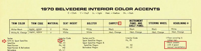

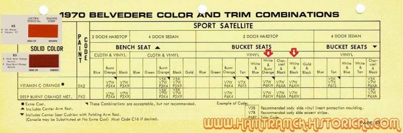

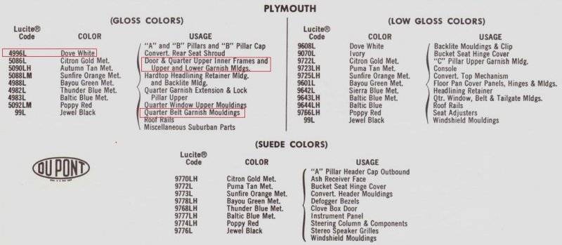

Based on your photo and your signature line, some additional info for you to peruse that's been lifted/cropped/compressed from Hamtramck Historical.
So I was able to cross reference EW1 and the Lucite number above. It is also called Alpine White and Spinnake White and white and spinnaker white and eggshell white across Dodge and Plymouth platforms in 1969 and 1970!
Dupont 4996L
Lucite 4996L
Chrysler DT1417
PPG/Ditzler 2033
Sherwin Williams 2342
BASF/RM 2063
Martin Senour 1554
