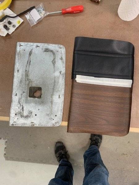

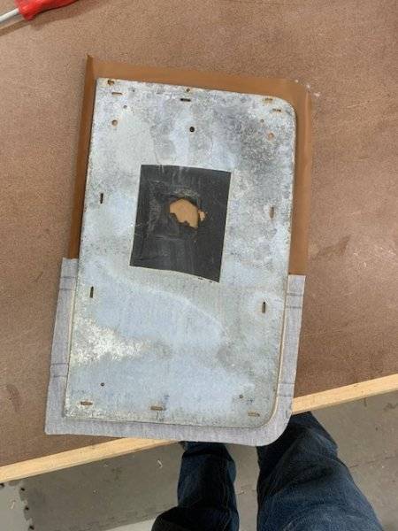

I am replacing the vinyl covers on the interior quarter panels. On the convertibles, the underlayment is galvanized steel and the vinyl wraps around it and is glued on. I'm looking for suggestions for the type of glue to use (vinyl to steel). You can see in the second pic how much is available to wrap around

I would try DAP Weldbond Landau Adhesive. It’s for vinyl tops and higher heat resistance. Only drawback is you may have to buy a full gallon.
I found some of that DAP Landau Adhesive in a spray can, worked great! Thanks for the tip
