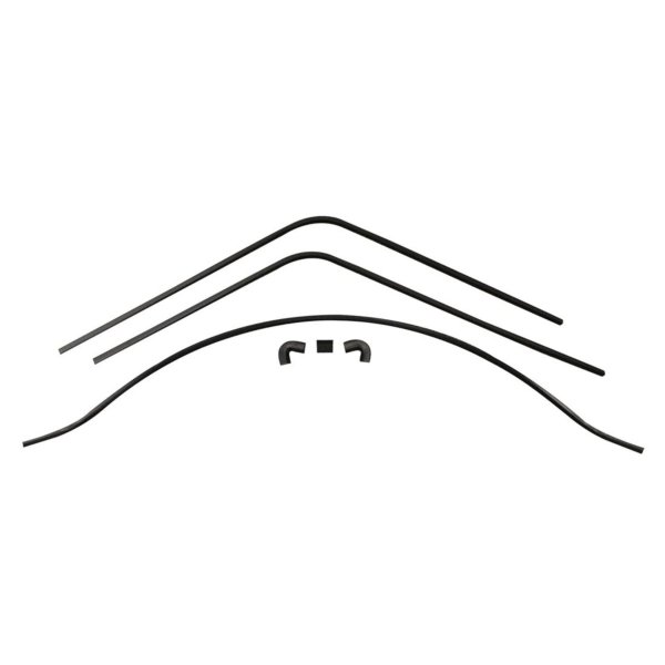

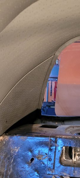

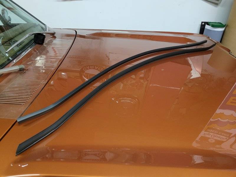

I have been working on the interior of my 1969 Superbee and have benefitted immensely from the knowledge on this forum. I am usually in too much of a hurry to take photos, make posts, etc. I searched this subject but did not find many solutions to this ubiquitous problem, so I decided to join the forum and use this as my first post. I bought the 6-piece interior rear window trim kit as illustrated in the picture and tried for 2-days to get it installed. In my opinion this kit is severely over priced and under designed. I did run across someone's comment that they used door edge trim. Sounded like a great idea to me, so I searched Amazon and found a high quality / low priced product that I just installed in 10 minutes. I am certain that this will work for almost any classic car. I just have it on the sides and top, decided to take a break, do this post and finish it at a later time. The plan is to use the kit bottom piece and 2 corner pieces at the bottom of the rear window and then black silicone sealant / adhesive in the small gap between the trim and window, for a pro finish look. This trim is very flexible, super easy to install and looks great. The U.S. and Canada Amazon link to the product is below, I purchased the 10-foot piece and that was more than enough to do the sides and top, this product is a little wider than most, which is what is needed, for maximum coverage, in case your have damage to the edge of your headliner, as I did:

That trim line **** is junk, sold by Year One.
Pretty sure I fully covered it in my restoration thread that's a sticky. We were just talking about this yesterday and I shared the link and showed the pictures of what "Dodge" used and "Plymouth" used. That said, many of our Bee's came with Plymouths system, thank god!
Rear Window Windlace Trim?
And Plymouth used basically what you've sourced for the sides and top.. and thanks for showing the amazon link!!

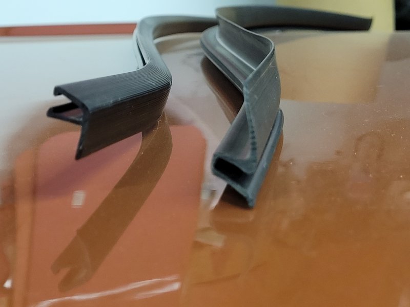

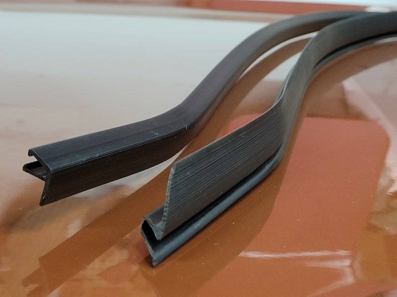

View attachment 1578994View attachment 1578995View attachment 1578996
Now back to the house before I find myself stung up like the decorations!
Awesome, yes, the one on the right looks like a better design and an easy installation. I am taking the 69 to Barrett Jackson Auction in Scottsdale next month, see what I can find from the vendors down there. It will be a while before I get onto the 68, lots of projects on the go, retirement is busier than working. Thanks for the follow-up and information. Merry Christmas
the one piece windlace type trim is F shaped so it closes the gap between the pinch weld and glass once installed
