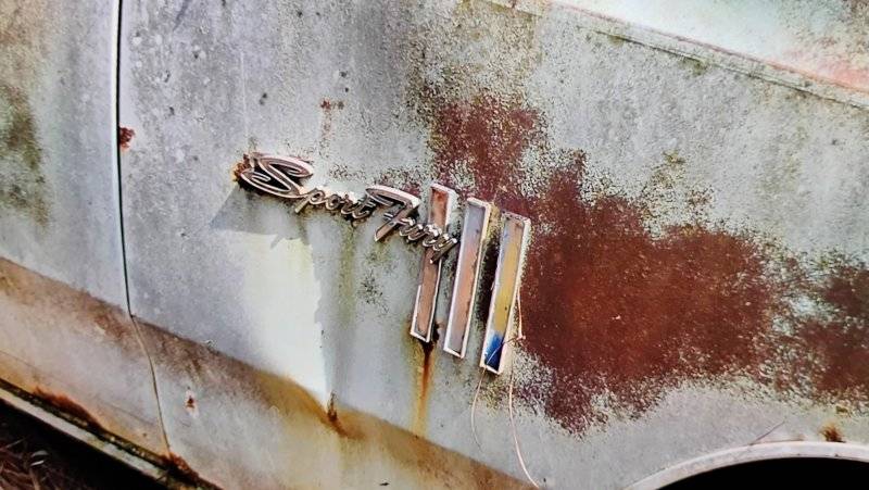

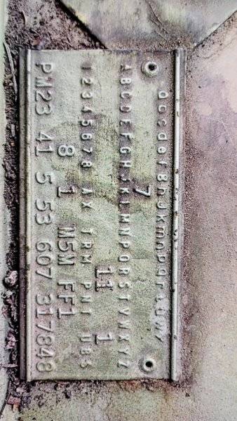

Hello my name is Phillip Im from the Texarkana Texas area I recently acquired 4 Plymouth fury cars 2 are 4 doors and 2 are 2 doors I know 1 is a sport fury 3 with the commando v8 badge 1 is a fury with the 400ci 1 is a fury 2 and 1 is a fury 3 I would like to know how or where I go to read this fender tag off of one of them can anyone help?
Welcome Phillip! Looks like a 2dr med. Plymouth with a 318 auto. 2.94 gear built June 7. And a Sport Fury is not a 3!
Ahhh ok I got you thanks for clarifying. Sport fury was the highest package with a 3 being mid level under the sport correct?
That's right!
It would seem it is a Fury III.
CAR: Plymouth Fury III 2 Door Hardtop
ENGINE: 318cid 2-bbl V8
TRANSMISSION: 3-Speed Automatic
TIRES: 8:25X14 White sidewall tires
MODEL YEAR: 1968
BUILD DATE: June 07.
AXLE: 2.76 Rear Axle Ratio
INTERIOR: , Vinyl Bench Seats. (M5M didn't give a colour. M5X = Black, M5W = White/Black, M5G = Green, M5T = Tan, M5R = Red, M5B = Blue.... so Magenta, Maroon?)
PAINT: Light Green Metallic (Dodge), Mist Green Metallic (Plymouth), Frost Green Metallic (Chrysler, Imperial).
MOLDINGS:
78: Wheel Lip Mouldings
ABC OPTIONS:
R1: AM Radio
S1: Air Conditioning
X1: Tinted Glass (all)
abc OPTIONS:
h7: Fender or Hood Mounted Turn Signal Indicators
Welcome from Connecticut. You have a fleet of cars but only a picture of a fender tag and a dent in a fury. More pictures please!:thumbsup::xscuseless::thumbsup::thumbsup::thumbsup::thumbsup::thumbsup:
