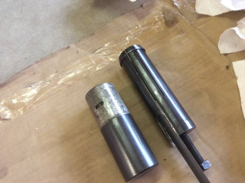

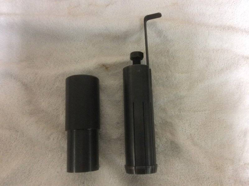

I'm sure you need at least 3 inches, driveshaft to short you'll be doing this. Trans bushing removal and install tool, $135.

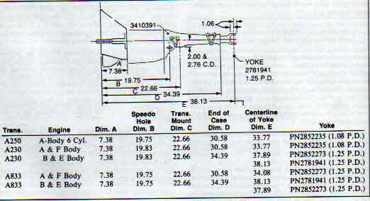

This diagram shows the slip yoke location dimension, subtract D from E.
