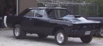

I did it to my 68' Dodge Dart in 2005 and it was nice having bigger tires, although I cut the quarter panels with a super stock template anyways so I guess it didnt really matter. (Attached is a picture)

Worth it to me just for looks. I like having the rear end low with big tires and not having the *** end jacked up. Not a huge amount of work but a pain constantly keeping things square.
I didn't do the inbrd kit but I expanded the outbrd wheel house halves (dehumped), since I had my 1/4skins off., and got the offset spring kit also. I considered mini tubbing/inbrd kit, but decided it was to much trouble for me for now, but I won't swear I won't ever do it. With the sticky street legal tires that we have today hugemongus tires are not really needed unless you're just wanting them for looks or have a hugemongus motor, jmo.
