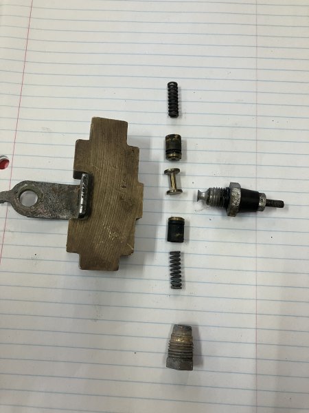

First time I looked at it. Not real pretty.
What rebuild kit do I get??

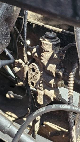

Did you take the wire off the valve switch? If not, based on that pic, your light shouldn't be on...
They are all pink on the inside !!!!!!!! :rofl: Would take it apart and clean every thing with WD Forty. Small soft brisel brush but not wire brush run through the body. Maybe some small trash in there. If not just might be in the master cylinder as stated.
I took the wire off. Don't need a red light in my face as I drive. I already know somethings wrong.
