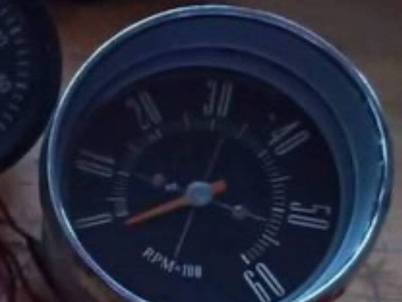

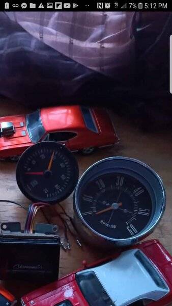

Is this tach for 67 mopar?
Do you have pictures of its attaching point, or on it's side.
The face looks correct but as Jerry said, a side view would help. The 66 tachs have a separate sender kind of in the size and manner of a tuna can. The sender function was incorporated into the tach case in 67.
Look close and enlarge that image. It is not a factory Chrysler console tach, but is damn close.
the numbers and scale are close, but it has extra lines & exposed bright fasteners. and look how deep the face is from the front, it has a deep chrome ring around the front. The shape of the chrome ring is wrong, too narrow.

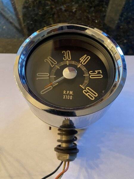

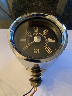

I saw this on ebay. Can you see the differences?
@Pepe70 Compare your body to this one, is it the same?

Yep, your right. Should have waited for the profile view.
Not Mopar, perhaps GM or Ford from same era.

Yes looks different let me see if I can get more pics. What I know 66 and 67 looks almost the same but are little different. I was thinking that that tach is propably 66 or 67.
Can you take some better pictures? Side profile, how it mounts, wires coming out…
For sure different than my 67 GTX was. It could be Mopar as I can't identify what it is for sure, I sort of doubt it though.
Looks like an Oldsmobile tach to me.

Olds maybe but not a 64 Olds Starfire. That had orange line at 5600 and red at 5800 and valve float at 5800ish. I found that out, that's all there was and ain't no more.
