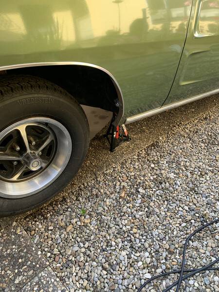

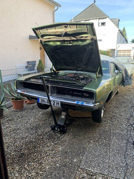

This is me jacking the charger up for the very first time earlier this day.
Not only that, its actually me jacking up a car for the very first time! (Except for with a little jack to change tires)
The jack was brand new before today.
I really prefer working with a lift or service pit (Which i do not have access to right now, unfortunately) instead of moving around on this kind of dirt floor. :D
But it worked, together with my dad and smoke machine i found out exactly where my exhaust leak is at!
Glad to see the jack stands!

On gravel , I always use 1” thick plywood under the stands and jack. So the legs and wheels dont sink in Plywood is cheap. A life or limbs are not.

Please chock your rear wheels.
Last time I used a bumper jack (on dirt) I lost a finger.
You can get cardboard at bicycle shops and appliance stores. Four layers of cardboard is almost comfortable. I use it for messy jobs to make clean up easier.
The stands are a good idea, but spend some money in better ones. I recently added three big ones I found on CL for $25. Cut plywood pads for them to set on.

A large piece of wood is still more stable than non grouted blocks that can move around. Especially the jack stands. Picture this, doing a pushup on just 3 fingers and then on the whole palm of your hand. See?
the weight is distributed across your whole hand instead of a couple of fingers.
When working on gravel, mostly on my Kenworth, I use hardwood blocks. I have 4x4, 6x6 and 8x8 hardwood "dunnage" that I use. The 8x8 blocks can easily handle my 21,000LB Kenworth tractor, and give me a sense of security when I am underneath.
