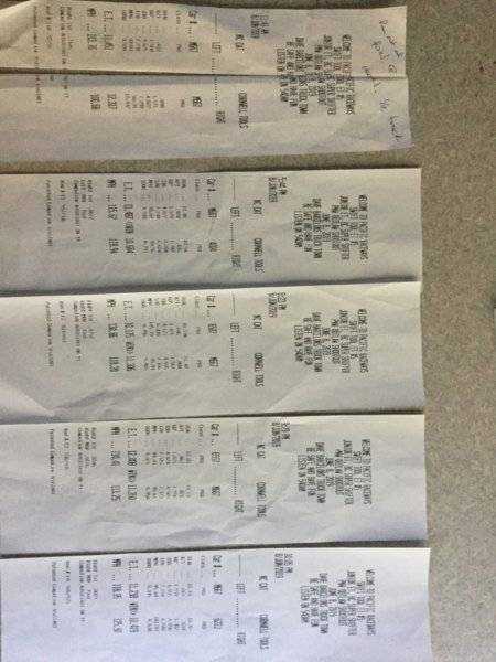

Well, it was a weekend I won’t forget anytime soon. It was a Sat / Sun double header. I’ll try to recap Saturday here as quickly as possible:
Friday afternoon: Home from work and I start in on trying to figure out the issue. Bypass the mechanical pump with the plan to simply run on the electric. Start the car.... about 3 psi pressure. ughhh, that won’t work. But on the positive side, perhaps I’ve found the problem(??). Then I remember that I purposely bought a pump that was low pressure, high volume, since I knew it was just there to support the mechanical. So I then bypass and completely remove the electric pump from the equation in effort to simplify the system, and re-hook up the mechanical. With the mechanical, however; it’s back to the guage looking like a hummingbird. I also went and bought a cheap little pressure gauge to double check things..... Exact same deal there. So finally at about 11:00 pm, I decided I would load it up and just see what it did.
Saturday: off the trailer, first run: pulls like normal through two gears but the pressure falls off and is at zero by mid track. Car runs to about 1000 ft and runs out of gas. Let out of the throttle and it comes back immediately, but the gauge is again fluttering like a butterfly.
Back in the pits and I’m under the car tracing every inch of fuel line looking for anything that doesn’t look right. A buddy then says: you should run to the parts store and buy a bunch of rubber hose and just replace the line from tank to pump. I consider this and realize it’s doable. He says you can take my truck (I’m in my motorhome which is already all set up for the weekend. I take him up on the idea and off to the closest parts store I go. About a half hr later I return with 15 ft of rubber fuel line. This is where the day got better: within minutes, at least 4 or 5 guys are over at my pit asking what they can do to help. We had this job done in time for my second hit! Start the car..... same issue apparent at the gauge. Go to make my second time hit: same exact deal, if anything worse. Car runs strong through first, but coughs and falls on its face midway through 2nd. I let out, and again it picks back up and runs out the back strong !?!?
Back in the pits and again the group gathers around. One of my buddies is a known carburetor whisperer, and this issue has him stumped. Of course he runs a much higher dollar system, so my rudimentary deadhead carter pump setup is not exactly what he suggests anyway, but he’s willing to help and suggests looking at the carburetor. We pull the needle, all looks good, and he concurs that the floats are exactly where they should be. We also pull apart the regulator and inspect... all seems okay there. At this point.... I’m tired and out of ideas. Last idea: let’s just pull the regulator out of the equation. We do this and I see a little more steady gauge needle.... perhaps we have something? Who knows... “I’m just gonna throw a number on it that makes sense, put it in the beams, and see what happens. My buddy Aaron says, as he’s wandering back to his car to get ready for round 1: “You know you’ll go rounds today, right?” I laugh and chalk an 11.40 on the car. Let’s see what happens.
1st round: opponent goes red, LemonWedge runs a full pass for the first time today: 11.48 @ only 115. A decent run, but still a tenth and 3 mph slower than the data suggests. But a win is in the book! From there, it’s 3 more rounds, including putting a couple of heavy hitters on the trailer, and the big yellow Plymouth is actually somehow running pretty strong. Eventually, a 4th round redlight kills me, and I’m out at 9 cars (74 car field). But in the process, the car on its final run of the night runs a new best of 11.23 @ 118.95! WTF!?
Pretty unlikely success. But the part that stood out to me was the comradery and friendship that was on display from guys around me early in the day. I’ll forget the races someday, I’ll never forget the help I received.
I’ll hit Sunday and more in a separate post.

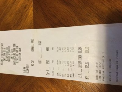

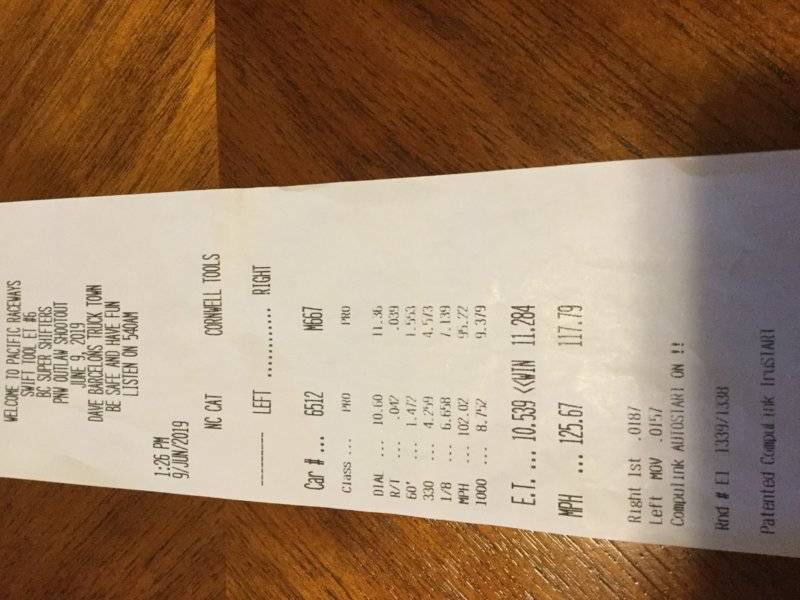

Sunday was much less eventful.... although my first round loss was one to remember and learn from. I drew 2015 NHRA National Pro ET Champion, and multiple time track champion Robert Steffen. He’s a hitter of the heaviest order, and I knew I’d have to be on my game to get to round 2. The car ran the full 1320 once again in my one and only time run, although the fuel pressure guage was again on zero from 660 on. It went 11.31 which was right in line with the weather. A couple of hours later, the heat was rolling in and the DA was up a bunch. I dialed 11.36 to his 10.60. We were both dead wrong...... Monumental tailwind???? I’m not sure, but the race felt absolutely correct at the stripe and I was able to hold him off, only to look up and see the win light come on in the opposite lane. I’ll let the time slip tell the story (I’m in the right lane)
