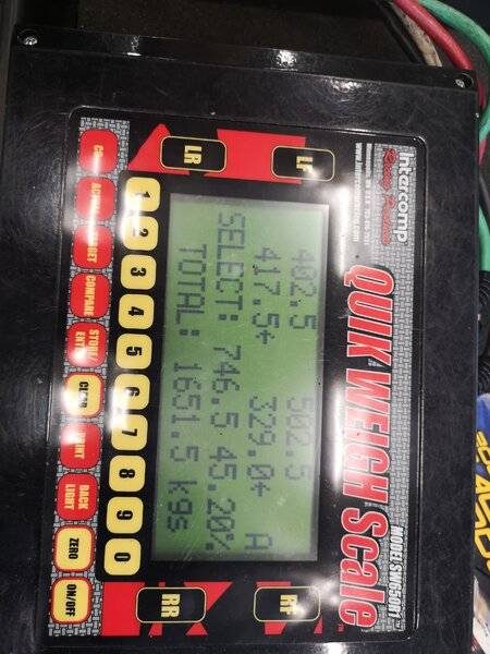

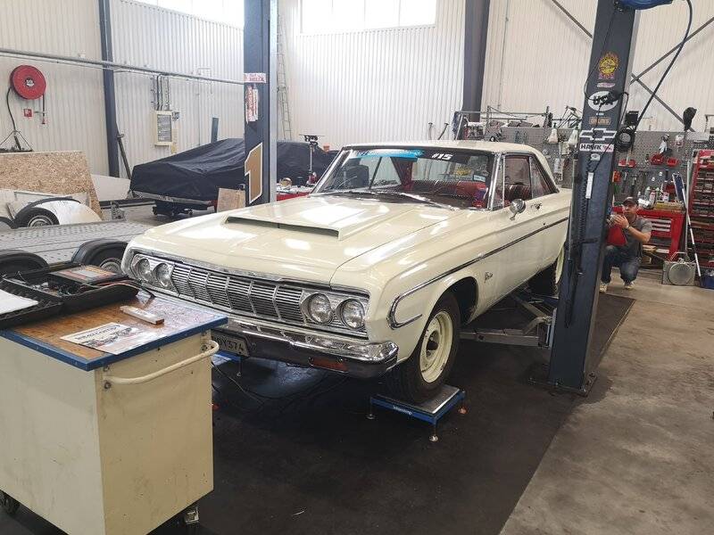

Just got my belvedere of the scales
kjalltrac
12:34 AM
Dec 8, 2014
330
248
Sweden Jonkoping
Fully stock body and interior
440 with aluminum heads
727 and 8 3/4 rear
Steelies with 26" slicks

Why is the right front so heavy and the right rear so light? I would expect the front and rear corners to be closer to each other than what you are seeing.
I would want it just the opposite corner wise for drag racing.....
He has said in another thread that he cranked up the torsion bar to try to compensate for a badly sagging right ss spring.
Interesting. I used to air up my passenger side air shock for my sagged spring. It felt like it kind of worked?
On subject, the weight seems good! I'd like to put my car on a diet without stripping it down. Still haven't decided where I'd get creative.
Cranking up the left torsion bar will add weight to the right rear. However with S/S springs the right should be stiffer than the left. Do you have the right and left on the wrong sides?

They are installed at the correct location, trust me, I've checked several times :)
Looks like the rear segment of the right main leaf is almost flat, no curv to it.
Like I posted earlier, the right main leaf is thinner than the left. Anyone who can measure the thickness of the main leafs, left and right?
Are they the 3400lb springs? They always seemed kind of saggy. 002/003 were better. A spring shop can add camber (rearch) to the spring.
