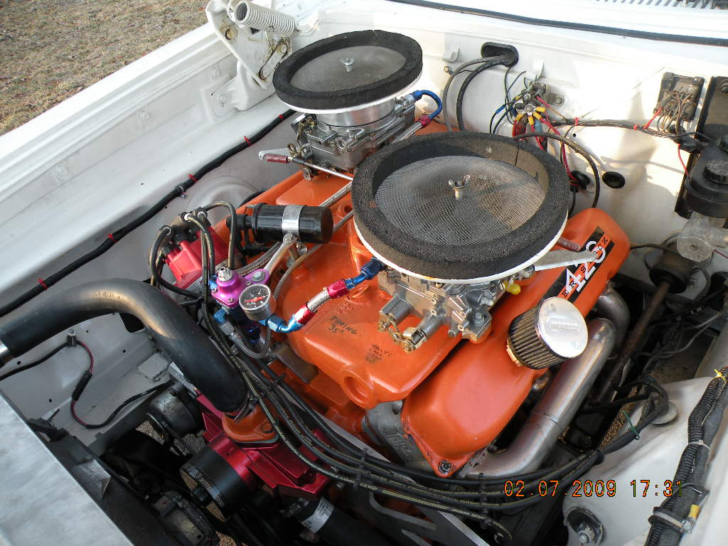

welcome aboard. i got one of those also. 63's are my favorite. you shouldnt have to remove the steering box to get everything out.
its not my 1st rodeo.
take out your exhaust bolts 1st. drain antifreeze, remove intake, remove valley cover,take out rocker,lifters, pushrods, head bolts, remove head and exhausts should come right out with heads out.
welcome, it's always nice to have more early B-body lovers here... please show us your car!
