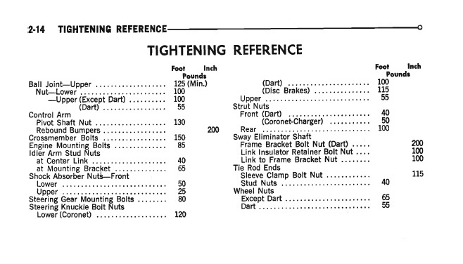

I'm trying to find the hardware torque for the k member in the service manual. Any hints? Thanks.
150 ft. lbs. that's the four bolts that hold the cross member to the front chassic
Torque rating for the 4 bolts that hold the K frame to the body?
Yes Cranky, can't seem to find it in the manual.
150 Ft/Lbs
Yup and I thought I was gonna drop something internally getting there :)
