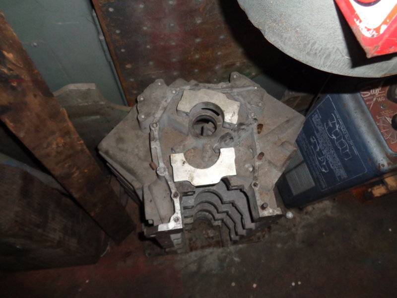

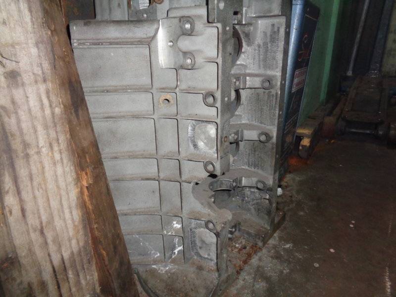

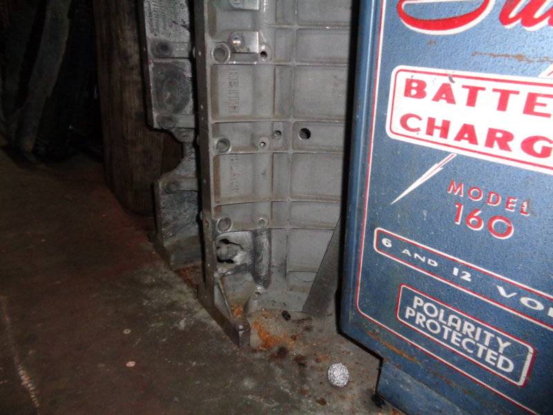

i believe the raised cam blocks have bigger cam bearing bores for bigger lift cams as well . here is my old one , got a crack up though the cam valley . its good for setup .
