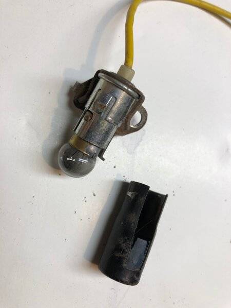

Rebuilding my steering column but this light here is being a pain to find. Local stores do not have it and Im not sure what part number in the Classic industries to use. Anybody have experience tracking down this little guy. Thanks

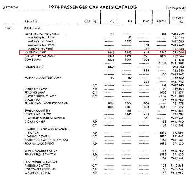

57 is the rallye cluster bulbs ( and console on auto floor shifters )... this is way smaller, kinda the 1892 Bulb and similar wattage ( way lower than 57 mini bulb ), but small round globe instead oval... will try to find the number. My book is on another continent LOL

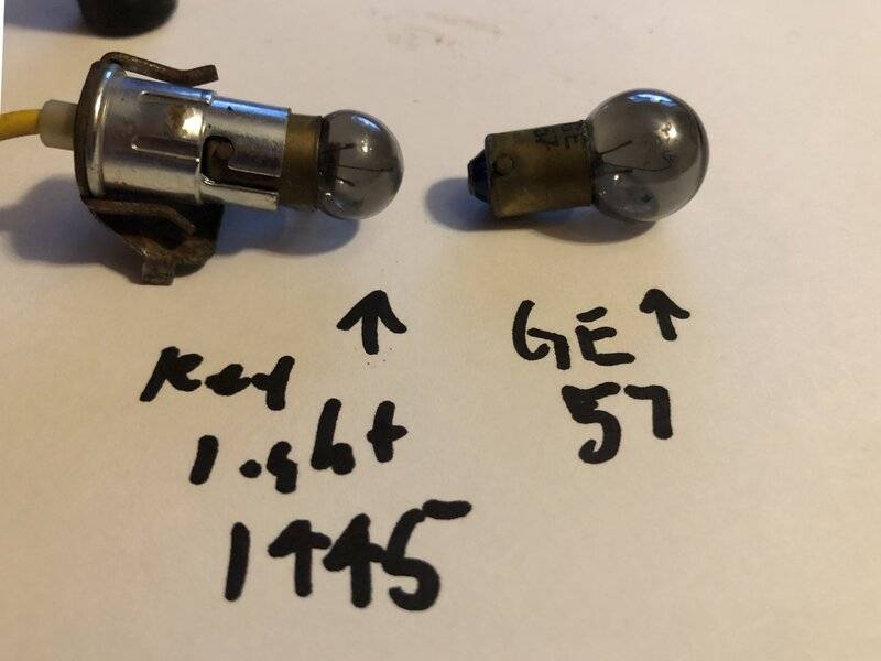

Light bulbs sure can be a pain. I took a picture of the 1445 and 57 together. I just replaced all the bulbs in the cluster so had a 57 sitting around to compare to. Looks like I’m off to order some bulbs. Thanks again For all the help. Really happy to be Chrysler guy with all the great people on this site.
Ahh I see its a little larger.. Good catch.. I was looking at a picture that looked like it. But apparently was deceiving.

I got bulbs at Advanced auto parts. They didnt have them on the floor. They were hiding in the back room someplace. Managed to get my column painted and put back together.
