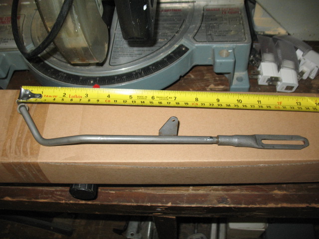

i will try to measure mine tonight or tommorow morning and i will post it for ya. mine is a three piece if yours is a one piece it will be different
Thanks very much, Mine is also a three peice. I just need to know the length of the rod that goes from the carb to the pivot point. The PO cut the rod and welded a longer peice to it.. there are many different lenths of kickdowns I just want to make sure I get the right one.

Al, Here,s the top rod that I have.

Wouldn't hurt to try it. The rod I have now is 15 inches and will not work at all.
I talked to a guy on Ebay who is selling the whole set up and he said the upper rod is 11 1/4 total length. But I can't confirm that is the right one.
The PO cut the rod at the threads so it is not even adjustable.

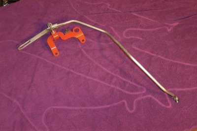

Ya I see them alot too. After owning several 71B/E with autos all had the one piece. My 70/71 parts book seems to show the 3-piece w/ bell crank on the 440 6-pack only in 71. I could be wrong, just what I've seen over the years. This one is from a 71 GTX.

Thanks Mark. I picked up the one that BEEZEE had, so will see if that works.
Thanks again for the info.
AL
Looks like it will work perfectly, and a great fit, the carb will open fully..now waiting on my ebay carb stud and we are good to go. Thanks everyone.
