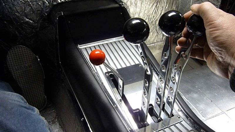

Ive seen a few people here and there w/ the Kilduff Shifters and IIRC have even seen someone on the A Body site graft one into an A Body console.
I was just curious if anyone had any experience with the shifters and the B Body consoles? Has anyone modified theirs? I have a multiple consoles laying around I can use. I still need to take the measurements of my console to see what can be done. The shifter I’m looking at is about 4.5” wide and 4” high.
(The photo shown is a ‘64 Ford Console modified)

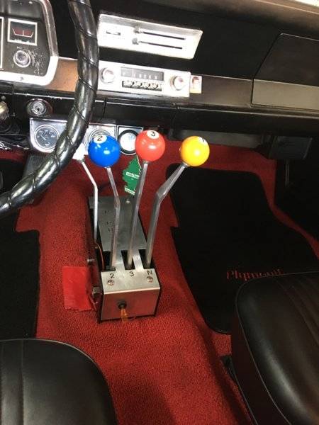

I got one in my Valiant. I’m going to do a console. Swear I am! Funny to see the looks when people check out the interior.
