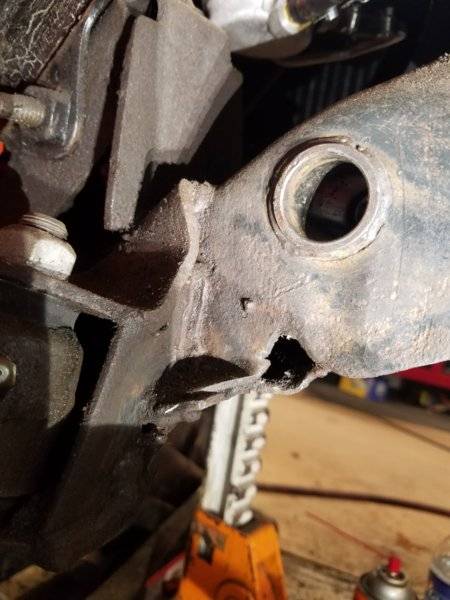

Take a look at your K frame, specifically the welded in bushing.
This side is actually OK, but the weld does have a crack line to be fixed. The drivers side was actually able to rock a bit. Caught this in the suspension I'm currently doing. Neither one gouged out the bushings but have seen it.
If it's been hit, you may want to take it to a frame shop to see if the frames are in alignment. Things may look OK but be off enough to give what you see.

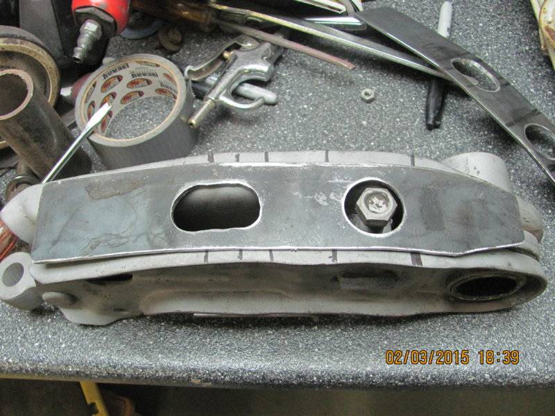

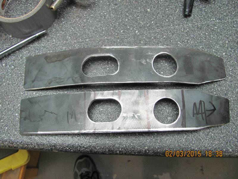

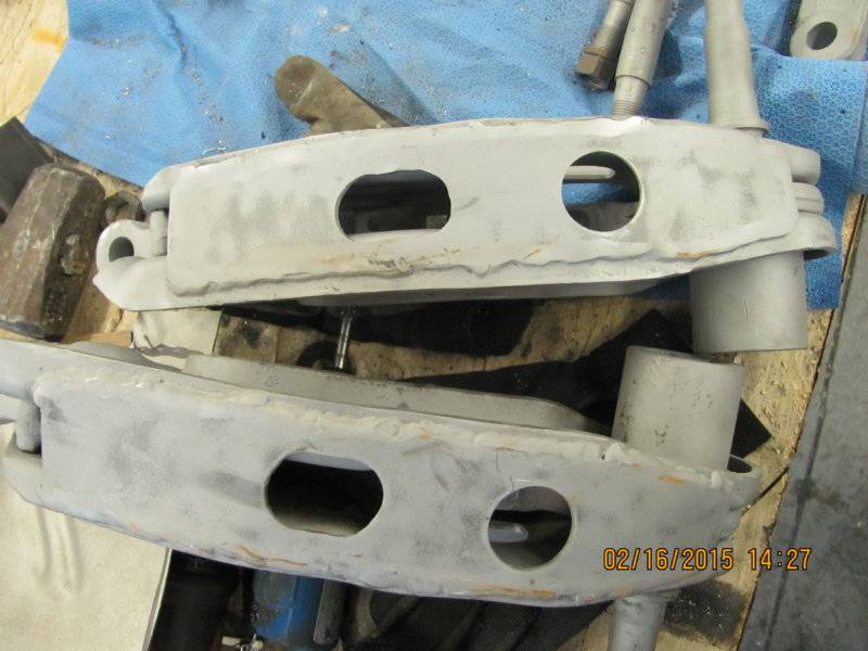

I read on FBBO that it was a good idea to weld a stiffing plate to the bottom of the lower control arms . There are several companys that offer them . I made my own up from 1/8 plate . Looks as if this is done it will stiffen them up and will have less flex . I clamped them up and welded on the plates . Food for thought . John
I Definitely wish I would have reinforced them when I had them off, my overhead welding skills, or lack there of will force their removal! It on my future rainy day list though.
