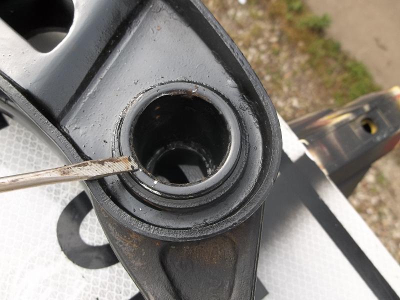

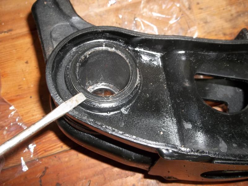

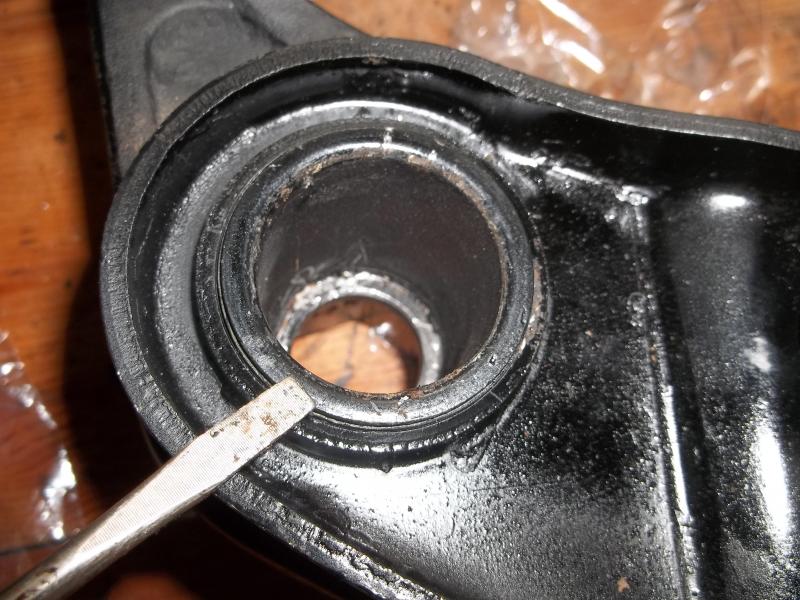

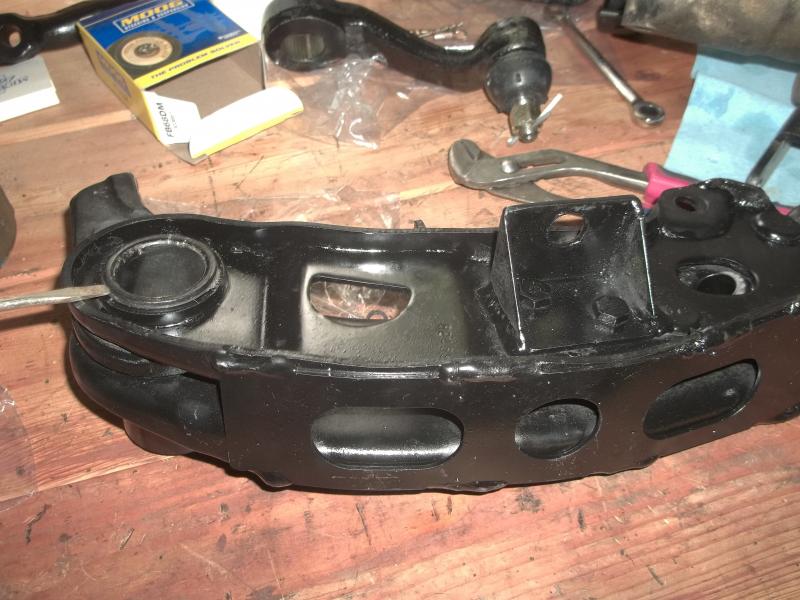

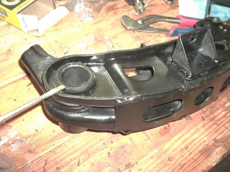

Before I go ripping things apart thought I better ask around. Attached are a few photos of a LCA that I have purchased and started rebuilding. It came without bushings excpet for what appears is the outer bushing shell.
Have seen examples on the internet showing different styles and fabrications on where the bushings go. I have tried to move what I think is the outer shell independent of the torsion bar fixture but it doesnt seem to move independently.
Can anyone give me some advice by looking at the photos if what is shown is the outer bushing shell or part of the LCA. The new bushing I ordered looks to be a bit small if this is the old outer bushing shell.
Also if it is the old outer bushing shell any ideas on how to remove it?

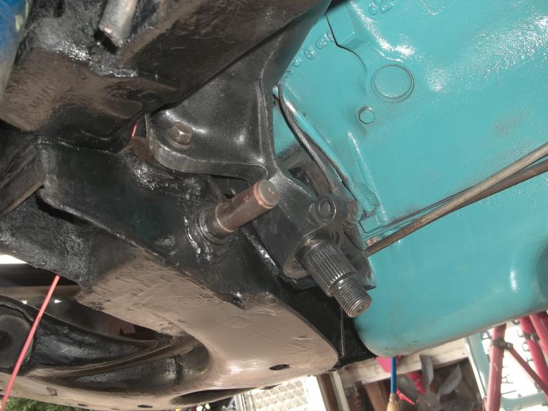

Also it looks like the old LCA pivot shaft has been welded into the K frame any suggestions the best way to mount the LCA?
That looks like the outer shell. The Opening is larger than that. if you run your finger down the inside when woy get to the bottom of the bushing you will frrl the bottom edge. Mancini Racing sells the tool to remove this sleeve
No need to remove it, just purchase the poly bushings and install in the existing sleave. Have you removed the lock nut from the pivots?
I started by doing the driver side first so the passenger side existing set up is still in place. yes I have the nut for the outer side of the pivot. I left the nut on and tried to bang the pivot out with a rubber mallet but it didnt budge.

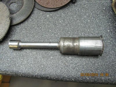

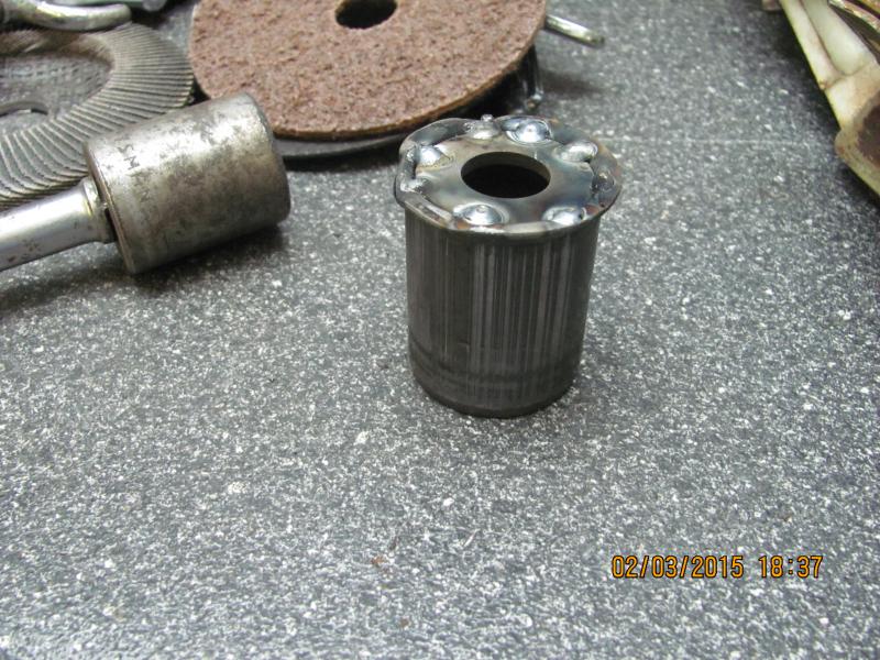

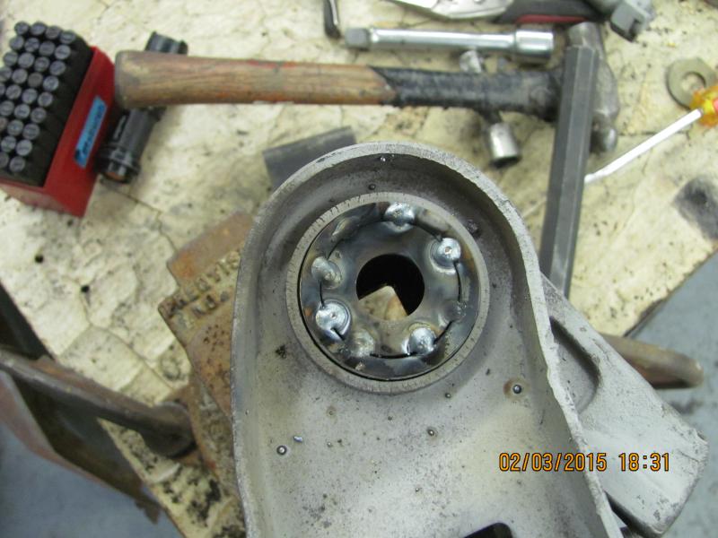

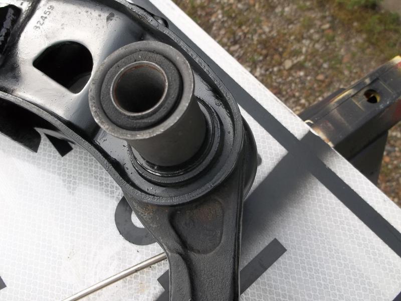

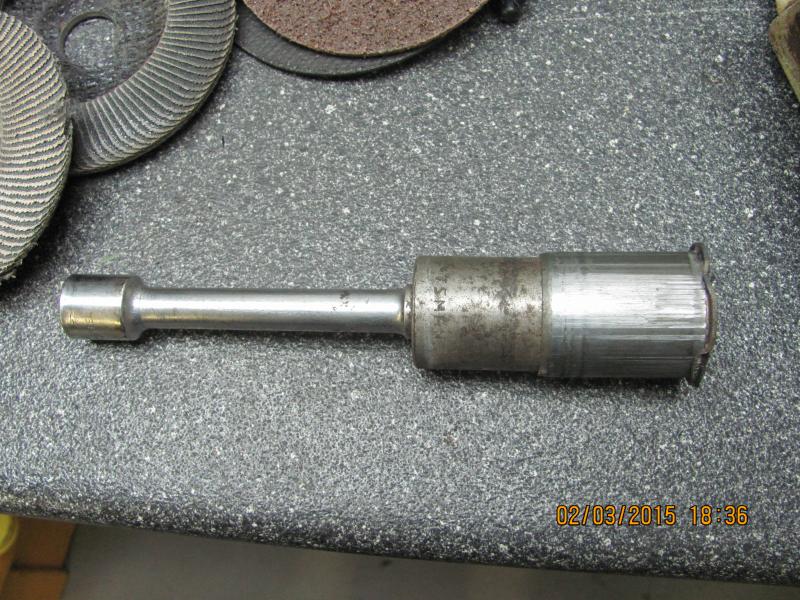

The lower control arm pin should come out by taking the nut off the front and hitting the end with a hammer , be sure to cover the threads with a piece of wood before using a hammer . as far as the sleeve goes this is how I removed it from my LCR . I put a socket that would just fit into the sleeve with the socket square down so you can use a extension to push it out later , find a washer that will fit ust inside of the hole and weld it in place in several locations . make sure not to weld it to the lower arm , then place a 6 inch extension in the back side into the socket that is in the sleeve and push it out in a press . takes about 5 minutes .1965 dodge 094.jpg1965 dodge 095.jpgto remove the sleeve from your lower control pin , after removing the pin take a cold chisel and lock it in a vise . use the chisel and make line of marks from end to end . do this again about 45 % on the next side . doing his spreads the bushing and will allow you to slide it off with your hand ..I tried to find my old one to show you but it's gone . if you look at your new bushing you will see the outer metal sleeve and the inner one . the old one on the arm will have to come off . I checked shops around where I lived and it's about $50 or $ 60 bucks to do this so I bought a press for a $100 and have the use of it later ... hope this helps ....

The lower control arm pin should come out by taking the nut off the front and hitting the end with a hammer , be sure to cover the threads with a piece of wood before using a hammer . as far as the sleeve goes this is how I removed it from my LCR . I put a socket that would just fit into the sleeve with the socket square down so you can use a extension to push it out later , find a washer that will fit ust inside of the hole and weld it in place in several locations . make sure not to weld it to the lower arm , then place a 6 inch extension in the back side into the socket that is in the sleeve and push it out in a press . takes about 5 minutes .View attachment 260399View attachment 260400to remove the sleeve from your lower control pin , after removing the pin take a cold chisel and lock it in a vise . use the chisel and make line of marks from end to end . do this again about 45 % on the next side . doing his spreads the bushing and will allow you to slide it off with your hand ..I tried to find my old one to show you but it's gone . if you look at your new bushing you will see the outer metal sleeve and the inner one . the old one on the arm will have to come off . I checked shops around where I lived and it's about $50 or $ 60 bucks to do this so I bought a press for a $100 and have the use of it later ... hope this helps ....
This is exactly how I do it.
