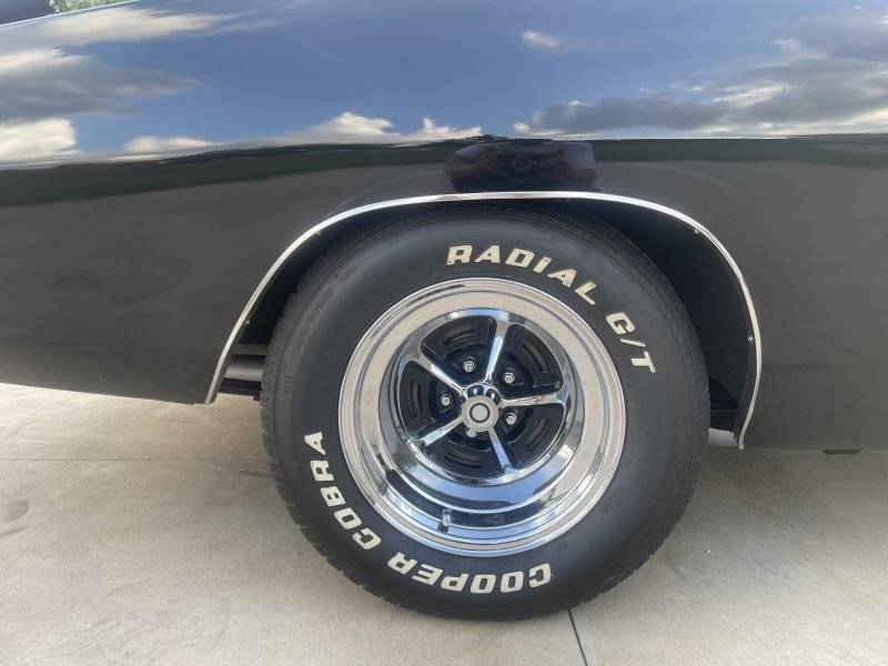

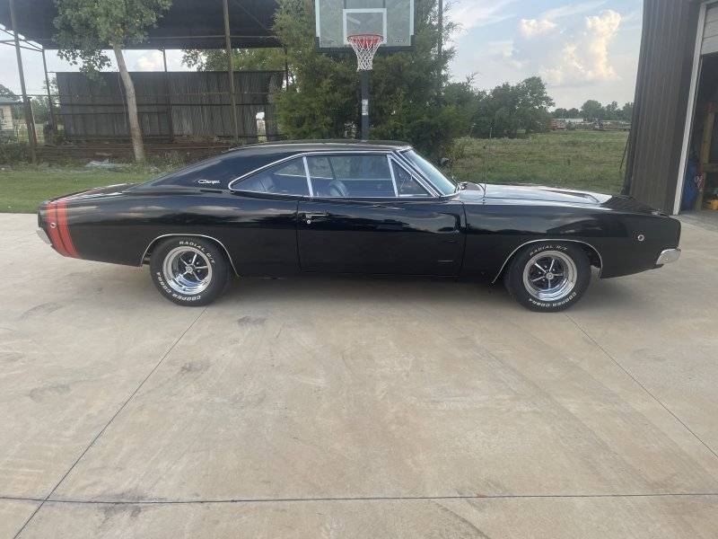

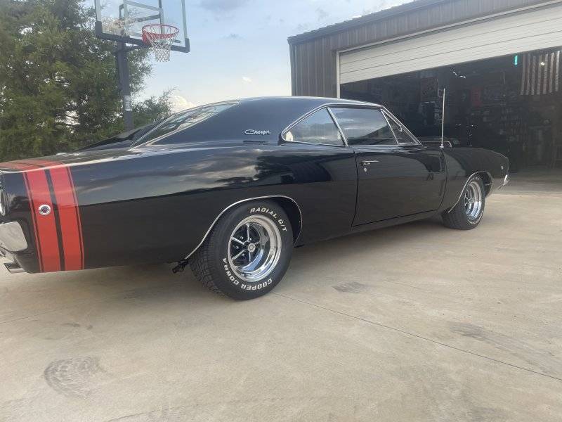

I have a 68 Charger with Hotchkis 1” drop leaf springs. I love everything about these, except the cost (pics below). I’m looking for a good alternative for a 69 project car. I’ve seen a lot of positive feedback on the ESPO leaf springs. I am wanting the height to be similar to what I have now. Does anyone have pics of a charger with the 1” drop, stock or +1 ESPO leafs? Additional info; The fender is about 25” from ground. Wheels are 15x10’s with 295/50/15’s.

I actually did talk to her today. Very knowledgeable and super helpful. I’m still not certain what would be close to my current set up though. That’s why I was hoping to get some more pics. She did tell me that the majority of her sales seem to be stock or +1. She doesn’t sell a whole lot of the 1” drop because, as she noted, these cars sit somewhat low stock from the factory at the rear.

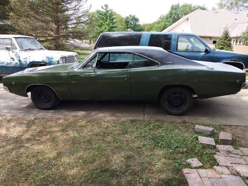

Not the greatest pic but these are +1 Eaton brand springs (I think) with 245 60 15 rear and 215 70 14 on the front. Thats why its raked in picture. Plus the driveway is angled down more than it seems. These arent the tires that I run just put them on to drive around the block. I picked the +1 so I could use a 255 or 275 tire plus I thought it might sag over time bit it doesnt seem like it has much if any and I put the springs on 10 years ago.

So would you say roughly 1” gap from tire to fender? Any pics with 275’s on?

More like 2 inchs of space between the top of the 245s and the wheel lip. No gas or spare or jack in trunk. No pics of 275s but I think it would look good.
