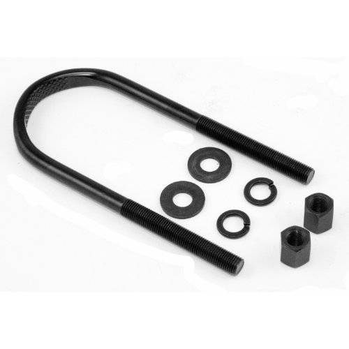

I suggest this type U bolts with the flat inside and X patterns to correctly hold you rear end.
The round ones will just dent in your axle tubes then let the rear end move around a little inside the U bolts.

I suggest this type U bolts with the flat inside and X patterns to correctly hold you rear end. View attachment 591027
That is the type I have now. I can't seem to find any for sale. I went to AMK site but they didn't have any.
