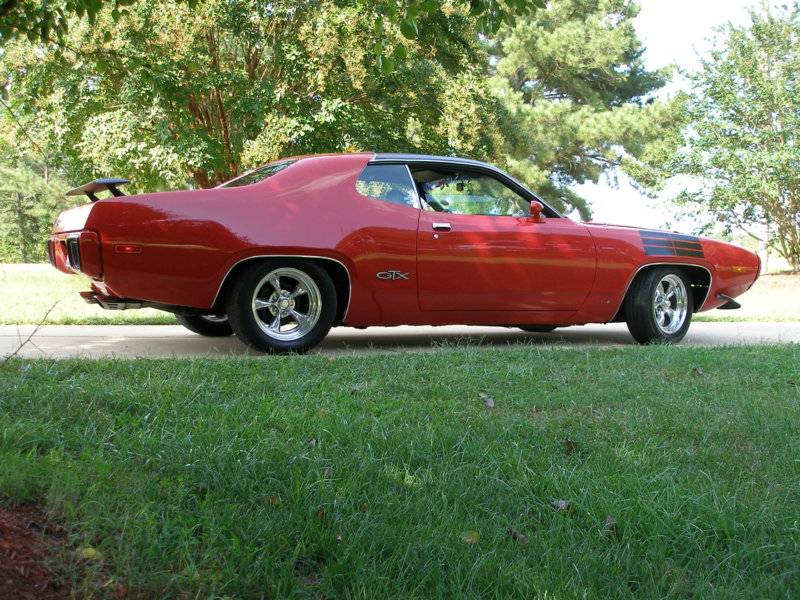

Hi all.
My leaf springs have finally sagged enough that i need to replace them. I found a place to purchase new ones (http://www.springsnthings.com/leaf-spring.htm) but my question is, should i get stock height or something higher/lower than stock to achieve the original look of my car before the leaf springs were sagging?
I figure, worst case, i'm better off going with stock height and lowering with blocks later.
Ideas? Suggestions?
Paul
The attached pictures show the rear tire size and how the car sat about 5 years ago.
Stock height if you like the look. Increased height if you want some rake. BTW, ESPO is a great place to get your springs! 440'

I told Laura i wanted stock but i'm sure they were 1" over.I made new front perches to lower the car an inch or so to the correct height.

So what do you think? Order 1" under?
I ordered stock height 10 years ago. They are still perfect.
No...just make sure she understands stock height
I would vote for stock height.
I have bought several sets of springs from ESPO. Didn't have any issues until my Duster. I am now on my 3rd set from her for that car. Still not happy and going forward will be paying up for Eaton Detroit Springs. Laura is very nice, but has no idea what "stock ride height" would have been.
