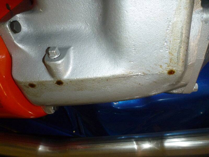

My tranny case has a very small leak in the bottom of the case (like 3 drops a day) The leak is in the cast iron I am positive about this. I called Brewers about this and he said it was probably porosity in the case and to seal it up from the inside and he has seen it before.

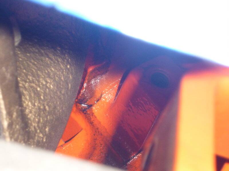

Back of the rocker cover...
I had a case where a weep was from a side cover gasket. There was a thin section in the gasket from a hole that didn't need to be there and I thought that was odd. I used it anyway thinking I'd just make sure the gasket was positioned properly but for some reason - maybe while seating the side cover - the gasket slipped and part of the hole was exposed causing a small drip.
I cleaned it with brake cleaner and then dusted it with baby powder and the leak is right smack dab on the casting line , no leaking gaskets or o rings .Good news is it passed the mag test with no cracks.
Soaking it in MEK and then going to coat it with some epoxy my brother pinched from work. I will let you know how it works
