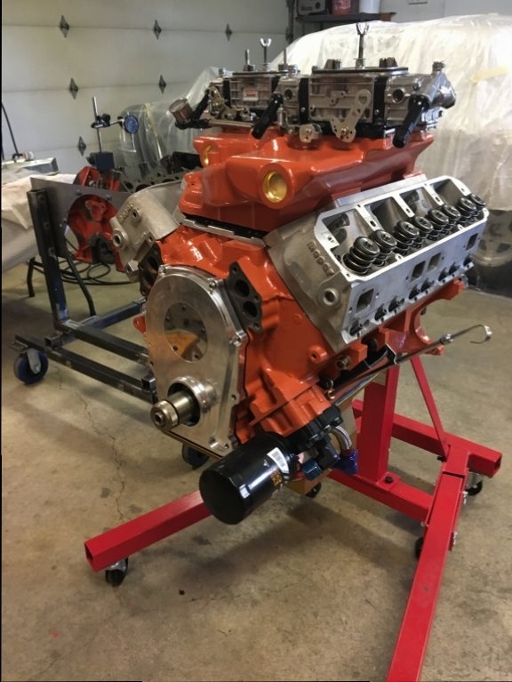

Is there a "rule of thumb" to go by as to what SHOULD be, in THERORY, the leanest cylinder on a 440 mopar? The combination in question is a 540" with crossram intake. I will be putting it on an engine run stand next week and have an extra EGT probe and gauge sitting around, so I was going to wire it up for the heck of it. I have been told in the past that #1 was, but that was in a drag car scenario

starting out with out of the box QUICK FUEL 750's ...22-74 jets
You know that intake is going to kill it. The Indy 440-25 is worth close to 100hp on that motor.

It's just a street motor we are playing with
without a load on the engine the exhaust temps will mean nothing,zero,zip.
