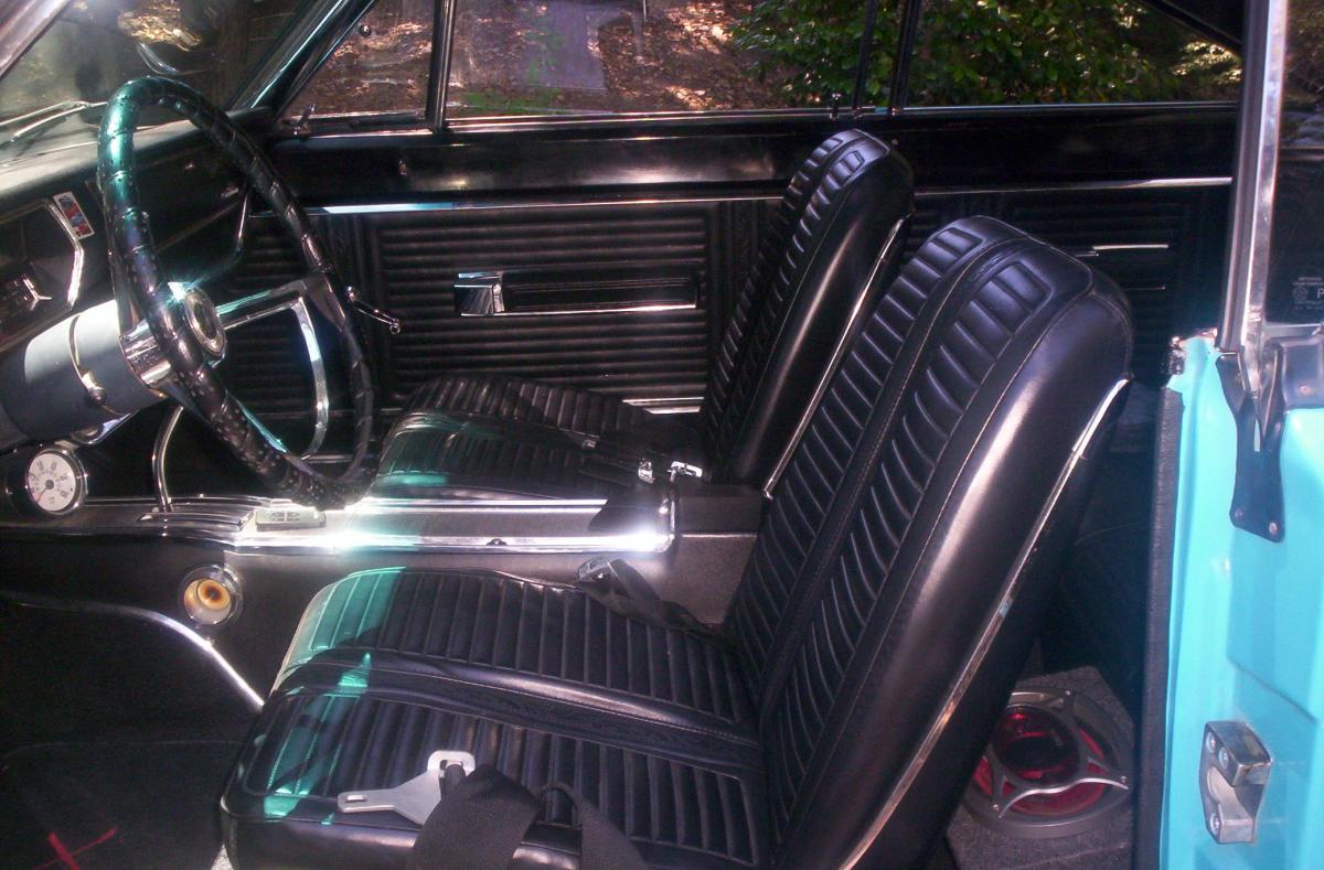

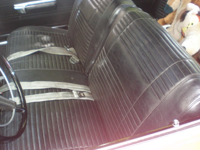

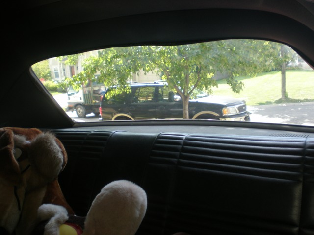

did it myself. What do u guys think?
Looks very nice to me. How long did it take you? Did you have to use new foam or was it in good condition?
They do have the best...Did mine myself too..

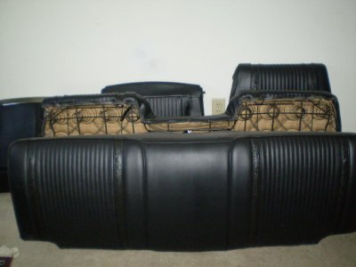

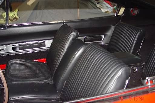

Yes they are. I've doing mine for a number of years now with great success....:yes:

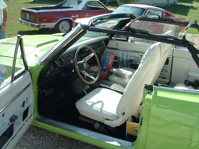

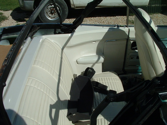

the upholstry looks great. is there any tricks to putting it in. iam going to try it myself. i live about 10 mi. from legendary interiors. thanks.
let the skins sit in the sun for a bit and get warm.
It also is easier to have help holding the skins in place while your attaching them with hog rings.
i throw mine in a pillow case tie it up and throw them in the dryer for ten minutes . they get nice and soft and stretch right on .
What, the sun doesn't work out in MO? :toothy10:
