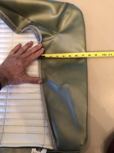

Has any one had experience of installing legendary seat covers on a 1966 charger? I'm having trouble with the rear seat, backs. They squish the springs so tight I can't get the hardware on the sides of the seat. My original covers measured 6-1/2" from the piping to the back seam, The ones I've got measure 5" from the piping to the back seam. Thank you, Terry

I've been trying to get information from them for two days now, And they haven't called back yet. I'm afraid they might have sent the wrong backs, Also the right and left covers are both the same part number, I would think that they would be different.

I experienced this too. The piping is thicker on the Legendary covers. It prevents the stainless trim from seating properly. You have to cut the piping down to allow the stainless to sit flush.
