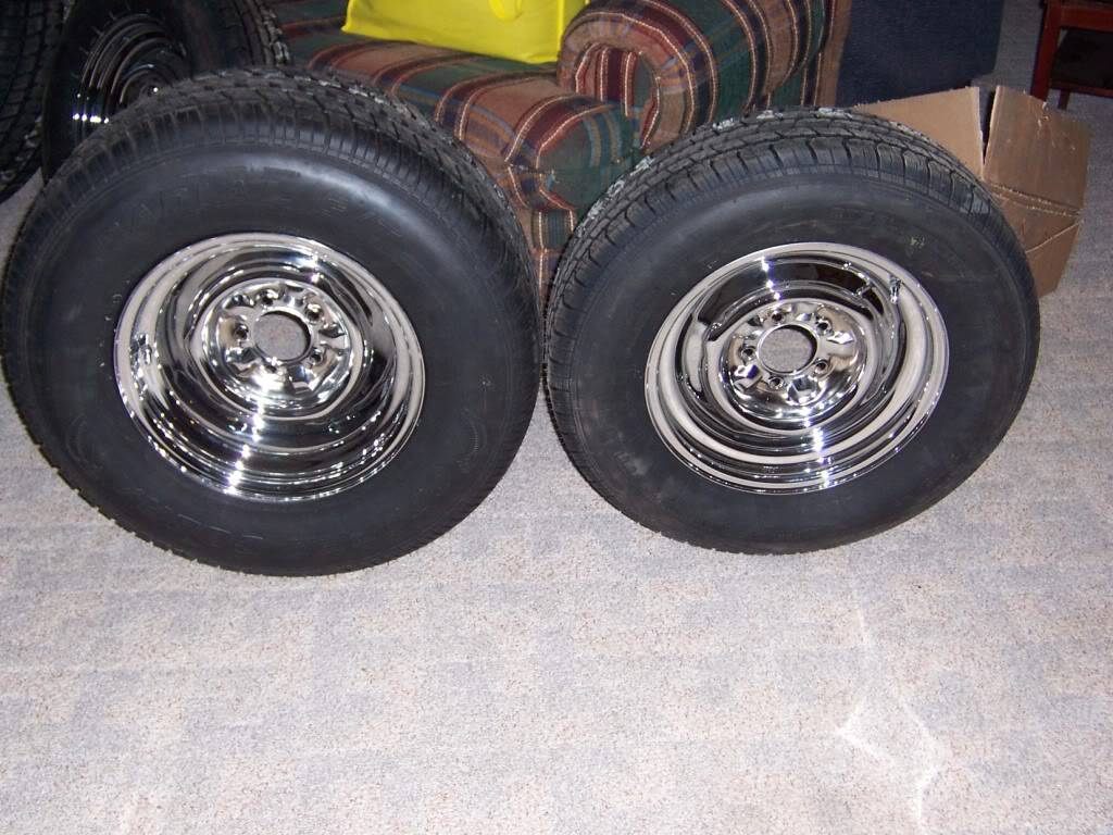

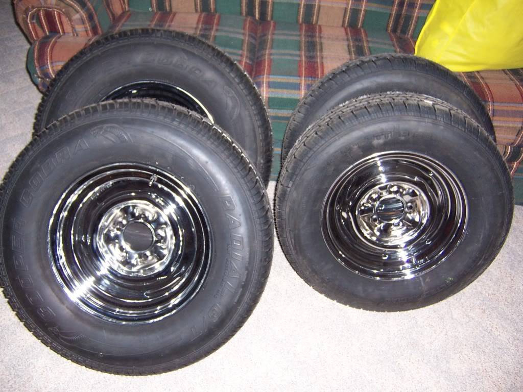

All right,we have some new rolling stock for the S.F. Seriously had considered Americans,like many others,but went back through some old books and magazines and decided on these:
Chrome OE steelies,15X5" and 15X8" with 205/75-15 front and 255/70-15 rear. They're from Rallye America,and I,like MANY others,highly recommend them! Still working on other issues,so for now they sit in the house. Hey,it's my house;if I want to build the 440 in the kitchen,I will...

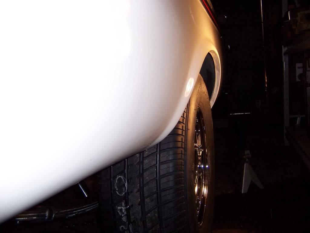

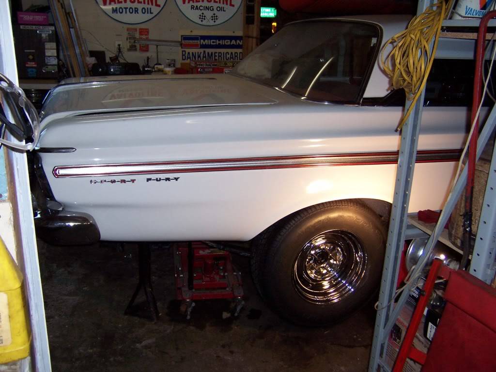

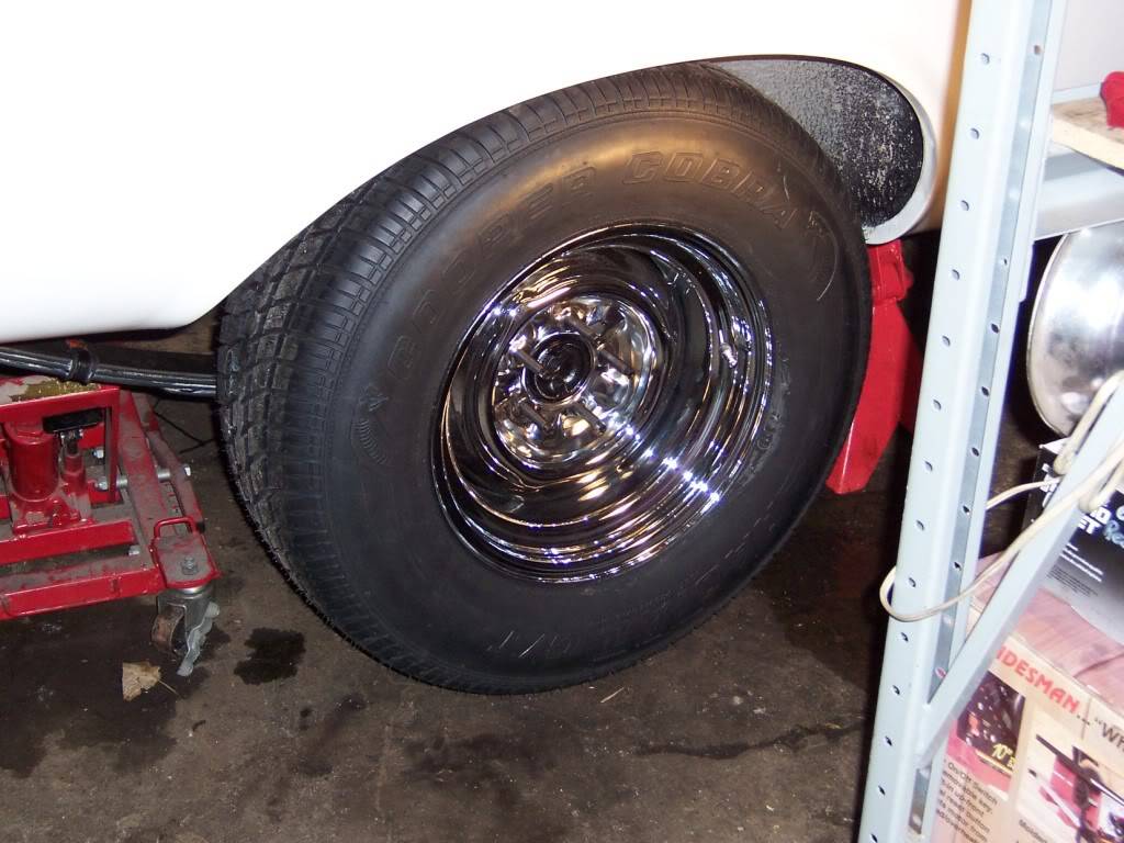

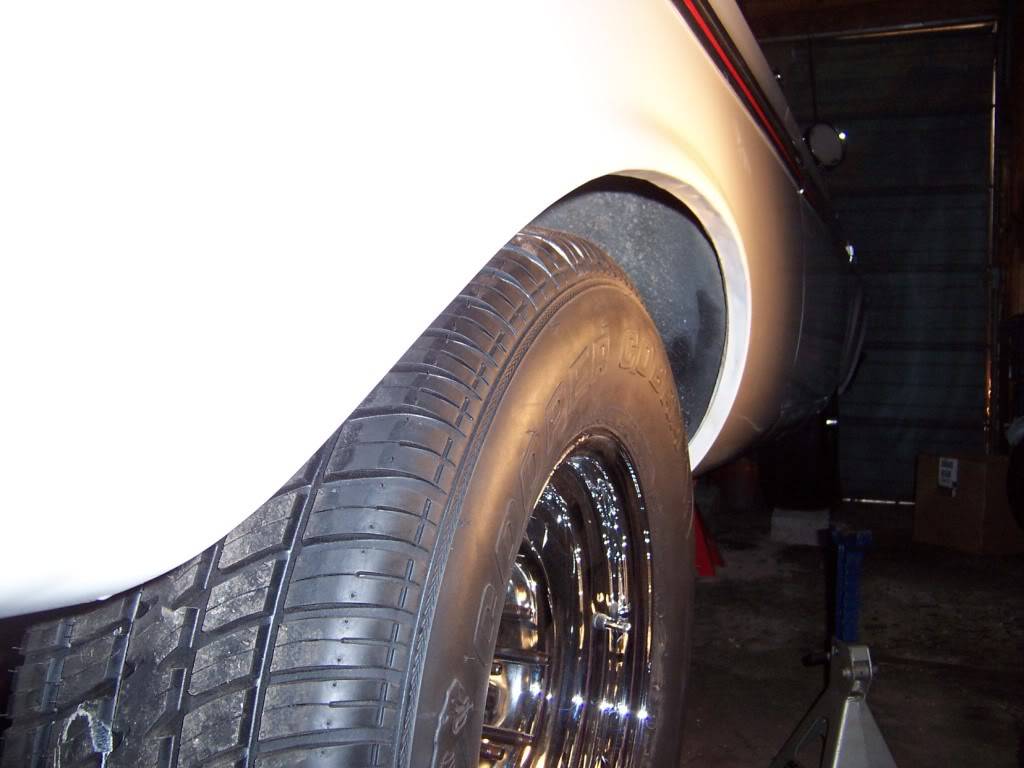

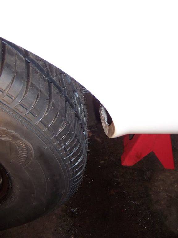

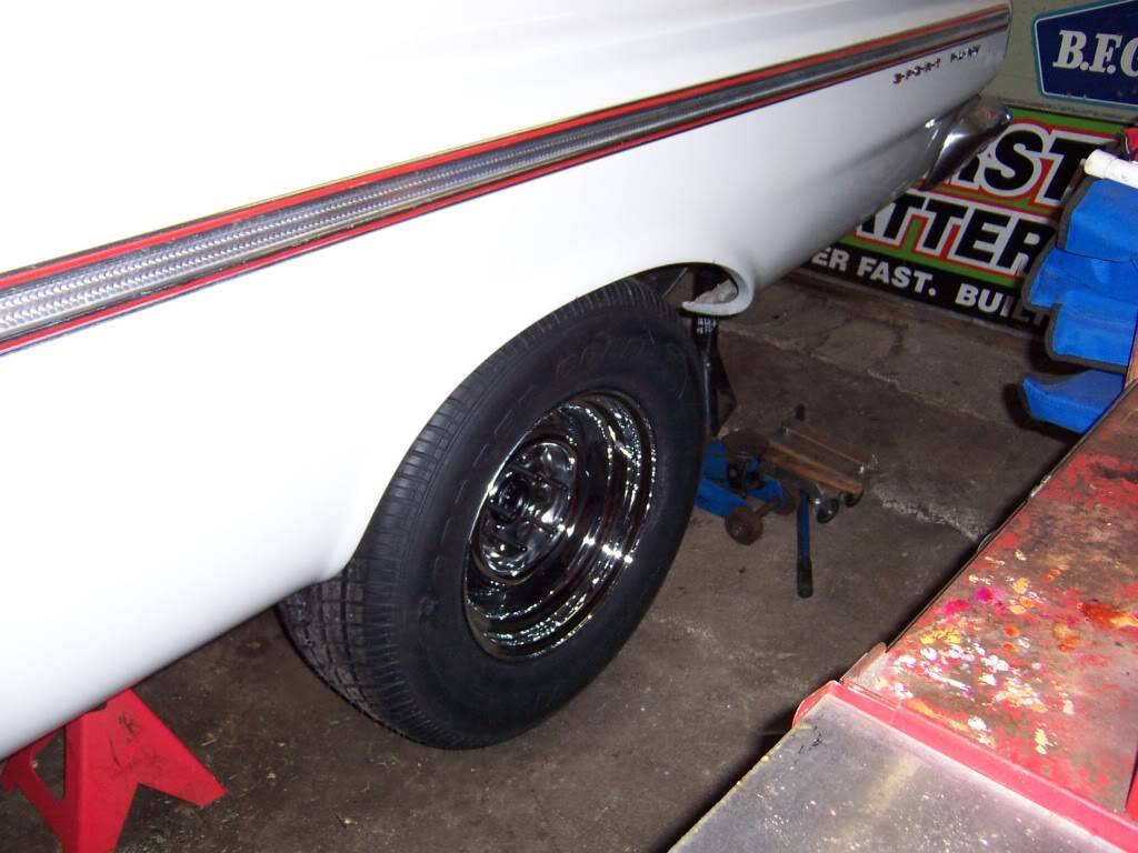

As soon as the car is road ready,they'll go on. I do need to get 'em on and see where my ride height is. I know with the rears I'll have a bit of a "rake" to it(intended),but also know I'll probably have to raise the front slightly before alignment.Here's some "teaser" pics:
There's no clearance issues with the springs or the front of the wheelhouse(it's c-l-o-s-e);it's with the top of the wheelhouse. Them's some big-*** tires! They're 255-70's;I may have to go with 255-60's or 235-70's. The wheels only come with 4-1/4" b.s.;a 4-3/4" b.s. would have moved the tire in just a bit more.
I really don't want to change the style of wheel,and I may have to contact Rallye America(where I got the wheels) and see about "cu$tom" wheels with the required offset. Ouch.:black_eye:
