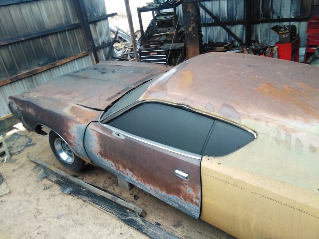

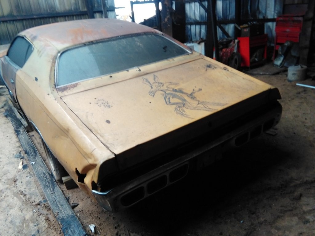

Why don't,t you buy my 71 roller coyote dodge charger say 1500 bucks. Email. D v H903 @ all.com
for sale
1500
Pm me
