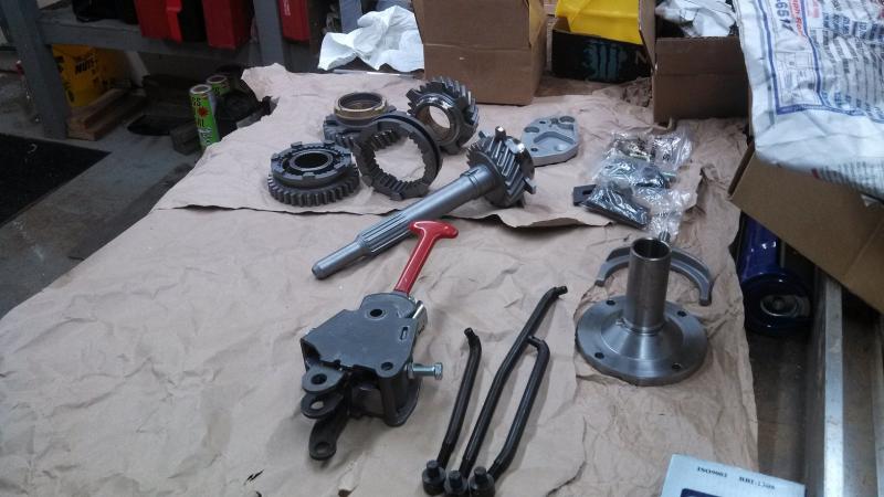

I have run a few different styles of performance modified a-833's on the street. It's not apples to apples in comparison but I would say that if you don't mind a little noise and drive the thing in a civil manner (not jerky on the throttle, etc.) it's very easy to drive. Have you seen a picture of face plated gears at all? If not I can post some. Essentially instead of a synchro assembly you have a large stator looking gear with five "paddles" that is accepted into the aftermarket clutch hub with a complimentary pattern. What this does is extend your "shift window" in comparison to all of the little teeth that must mate in a synchro assembly. I really like my trans that has been face plated.

Ok, so I spoke too soon..... After doing a lot of research and watching YouTube videos of guys running face plated transmissions on the street, I decided to go ahead and do it plus a lot of other stuff.
List of mods........
Face plate 2nd-4th gear, threaded front cap, linkage upgrades, new seals, bronze fork pads, convert to .82 5th gear, thermal stabilization, shot peen
