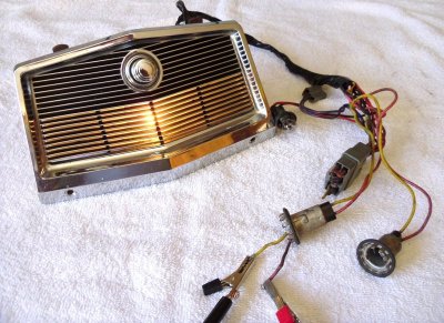

no light at rear of "B" body console, it was a "C" body thing, also kinda rare. never offered in the Charger of any year
like this, C body only.

Thanks everyone for your answers. I guess the one we saw in the past was an "adaption" by someone restoring theirs. Also, once the back plate was actually installed onto the console, there is no gap. :-)
Yup, a "C"-body piece. BTW, the '67 - '70 "B" & "C" consoles are the SAME. Only differences are what style of top (ribbed, smooth stainless look, or woodgrain) was on the console. The '66 is a two-piece on "B" & "C" cars, because of the console extension on the '66 Chargers, and the filler "butt" piece on the other console cars. The '70 Chrysler has a different console (look at a '70 300-H as an example).
