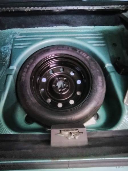

My originals wheels was steel wheel 14x5.5 with Goodyear tires 215/70/14 (25.85 dia.).
Tires was more than ten years old, so I make a switch to15x7 Magnum 500 with 225/70/15.
Now I need a spare tire...

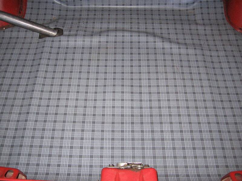

I can buy a 15 inches rim with a new tire 225/70/15 (27.4 dia.) but the cavity in the trunk for the spare make a big bump in the trunk... for the Dodge Charger 1967.
I wish have a spare tire with less width, so I make research on the net to find a thinner tire with the same diameter, wheel pattern and hub dia.
After a few beers... I finally found something interesting.
07-14 Ford Edge, Wheel Rim 17x4-1/2 with T165/80D17 tire.
T165/80D17 = 27.40 dia.
Now the trunk spare board is flat like original...
And 14 pounds less weight too.

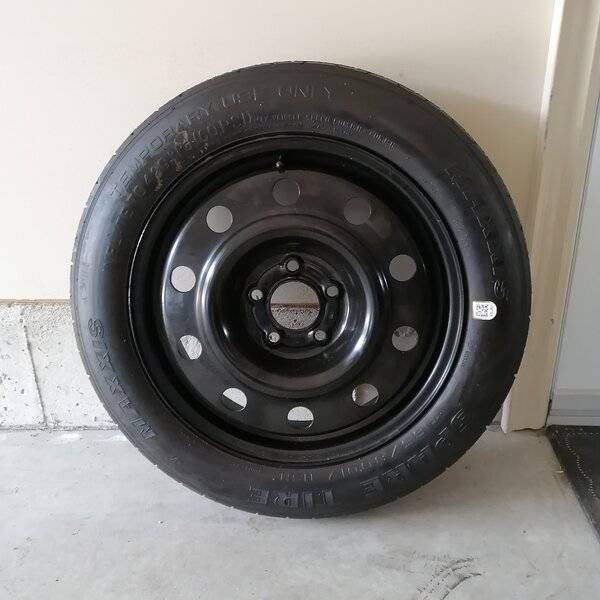

Thanks, I just put 17 inch wheels with 27 inch tires on my Charger and was looking for a spare that size.
I wanted to thank you, I just picked up a Ford Edge spare for my Charger. Never been on the road, and it is the same diameter as the tires on the car. I still have to open up the center hole.

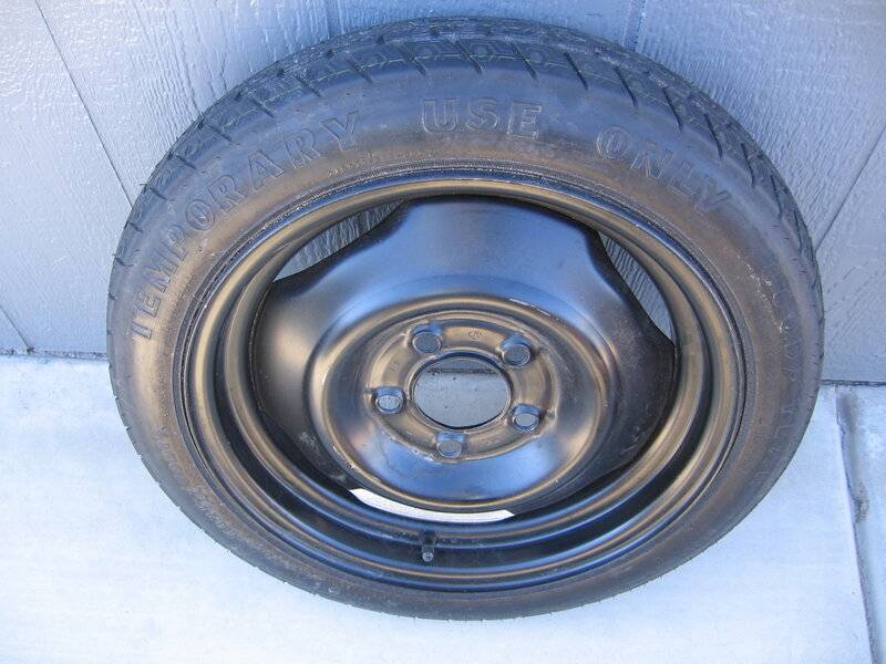

I was scoring these from pic-a-parts Late 80's Dodge Diplomat,Plymouth,Chrysler rear wheel drive.
Bought about 4 of them $20 each. When I did big bolt pattern switch on A body cars these fit disc brakes and fit the tire well nice and flat.
Bought couple wheel and put on and started the lug nuts. Got air wrench burp burp they're on. What f#%&in job to get them off, never will happen again. Did know there was a difference at the time.
Yes on Ford wheels hub register too small. Chrysler wheels fit fine.
