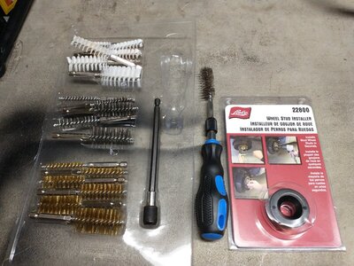

I bought this tool to replace the old wheel studs on the rear axles with new studs. Beat the old studs out, cleaned the holes with a bore brush, and installed the new studs in 10 minutes. I highly recommend it and the brush kit.
Lisle 22800 Wheel Stud Installer https://www.amazon.com/dp/B000ETUD2...abc_5PP69P0VW4XXR2CZHJAJ?_encoding=UTF8&psc=1
Clutch bore brush set.

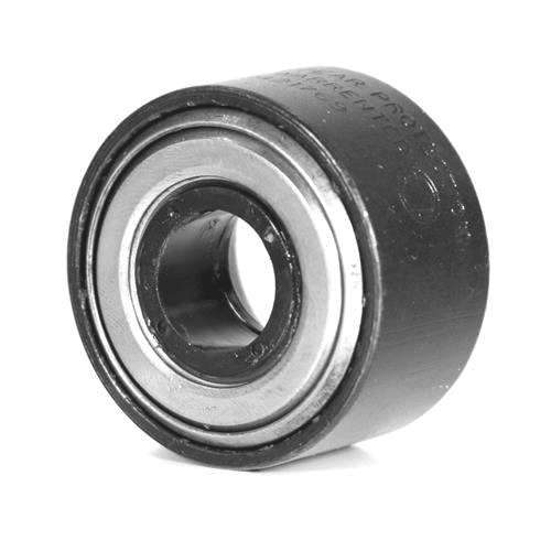

Looks like a bearing.
What does it actually do?
I usually just start them/locate the splines by hand and then run an "upside down" lug nut with a couple oversize washers down until it seats.
Looks to be the same concept. Start lug place the tool over it, tighten lugnut against tool until the stud is pulled through.
The bearing provides frictionless torque and pulls straight through the center maintaining alignment.
Read the Amazon reviews for a better understanding.

Be sure to clean up the bearing when done as it gets debris in it from installing studs. Especially, when the hubs or rotors are used and a bit gritty.
