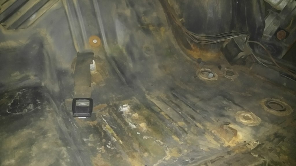

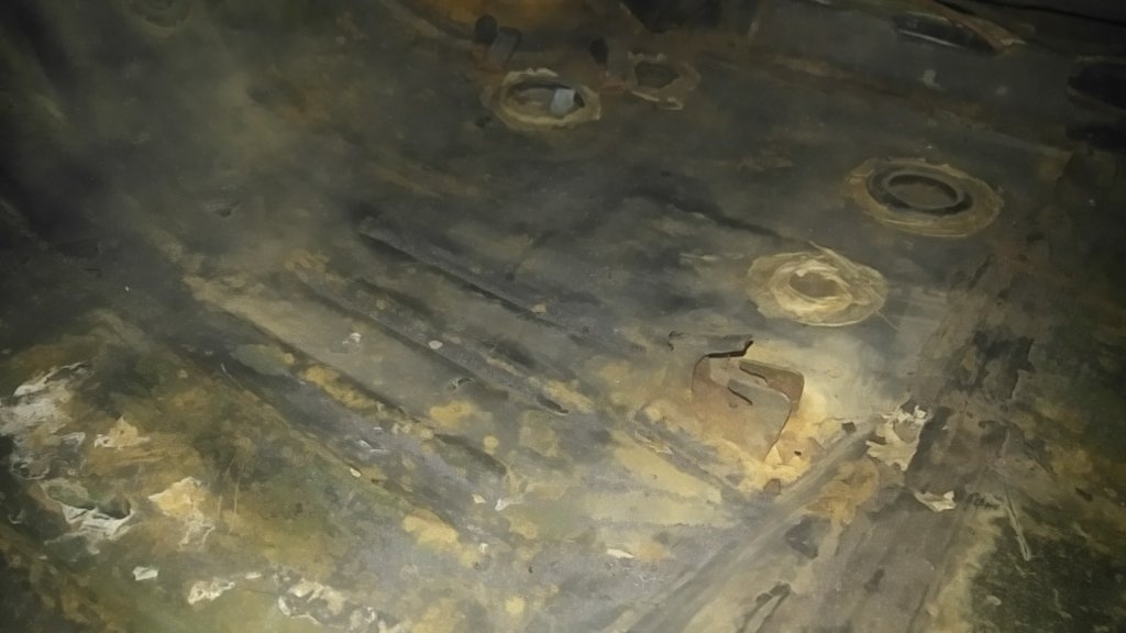

This is what the brackets holding the seat bottom in look like. You push back, then pull up and out.
