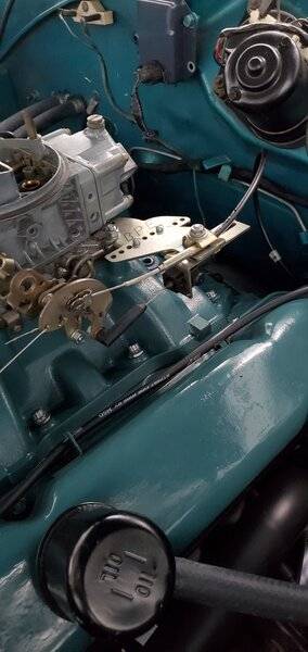

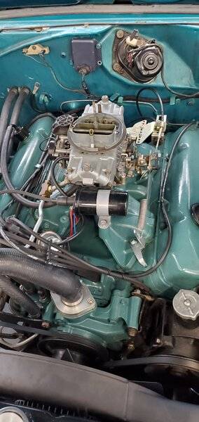

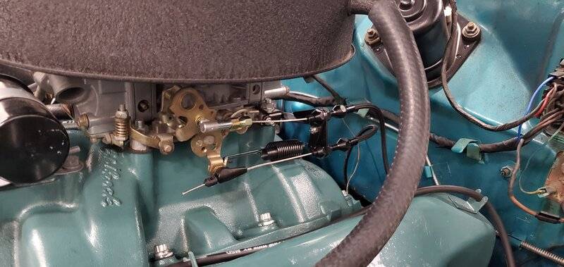

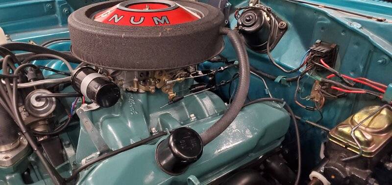

Got my Lokar stuff in the mail today and on the car it went. I must say, I should've bought this instead of that bouchillon junk. Looks much cleaner, individual cable adjustment is great and the throttle is much "lighter"...... yes I know, I still need to remove the old throttle return spring bracket!

Thanks, I really don't know whats to complain about. Install is straight forward and it works perfectly. I did add a small spring at the bottom to pull the kickdown lever forward when off throttle. Not sure how necessary it is but its on there now!
