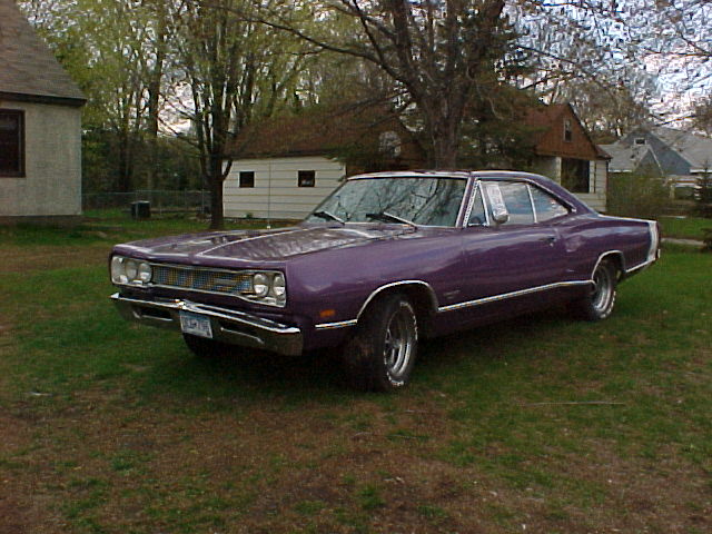

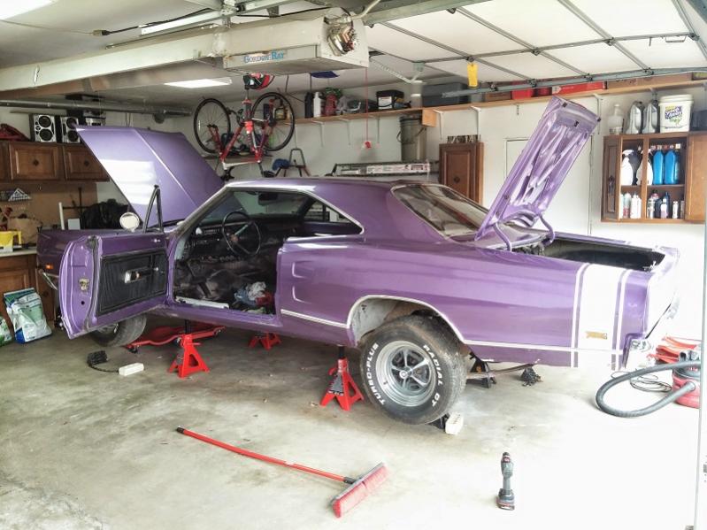

Fast forward a couple of years and after saving up from various minimum wage jobs and being extremely thrifty I was able to scrounge up ~4K to buy the 69 Coronet 440 pictured below.
While kinda ratty, slow, accident damaged, and incomplete, it was fun to have something classic to call my own. This purchase was done 2 months before I graduated high school back in 2002, while getting ready for college and still working part time near minimum wage jobs. Needless to say, funds were tight and upgrades had to be chosen carefully.

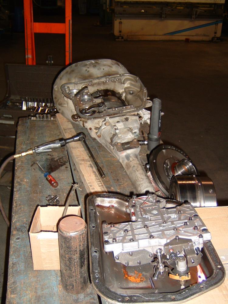

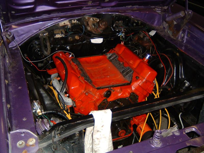

The first thing I wanted to do was swap out the mid 70's 318 that had found its way into the engine bay. Through my friend with the 66 Coronet I met an older guy (to us at the time anyway, probably only 35-40) who had inexplicably taken us both under his wing to teach us the way or the Mopar. He knew I was looking for a bigger engine and hooked me up with a 440 that was supposed to be ready to go and turn key. Turns out that after taking the valve covers off we saw 4-5 bend push rods just hanging out in the valley. Since the idea of just throwing the 440 in the Net and having fun got squashed, I decided I might as well rebuild it. Long story short, I had the machine work done by a shop, then assembled the motor my self having never done something like that before. The random older friend helped me a ton by showing me how to rebuild a tranny, with various upgrades of course.

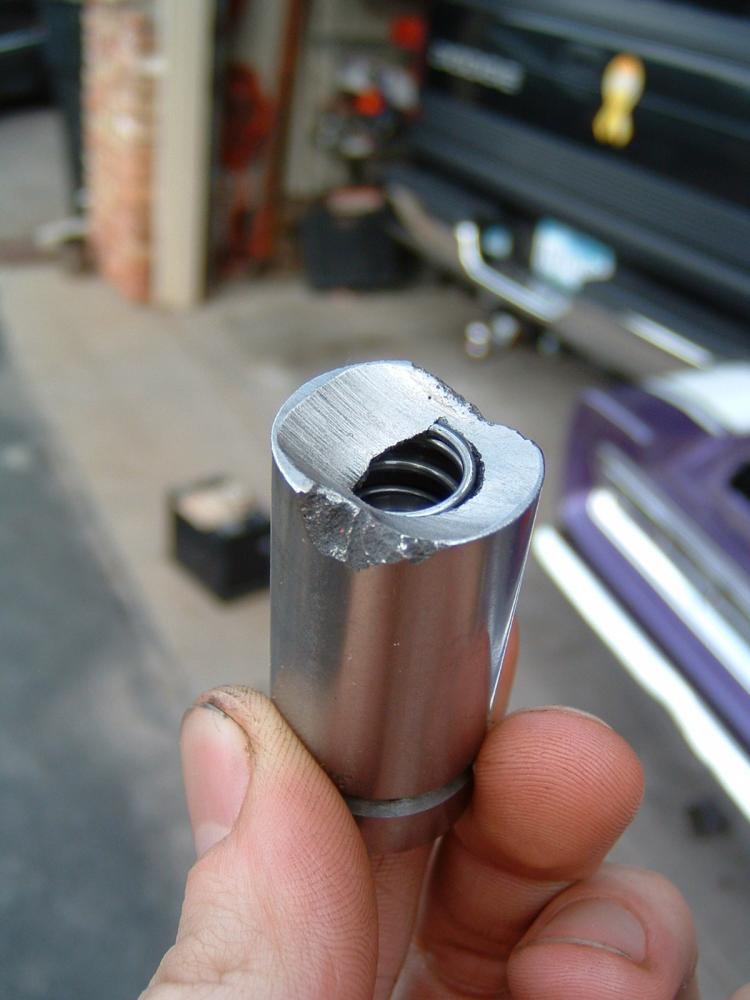

With the motor and tranny all put together and installed in the car. We fired her up and broke in the cam. She ran soooo smooth, it was awesome. Without any exhaust I drove to a shop (20 miles away) to have a 2.5 H-Pipe system fabricated/installed. After it was finished is when I could actually hear the extremely loud rattling. This was around 2003 and the whole lack of zinc in old thing was quite new and hadn't made its way to my ears yet. Take a guess what the cam/lifters did without proper lubrication.
Being that I was still on a near minimum wage budget, and stupid, I decided to pull the wreaked cam/lifters and just replace them. I knew it wasn't the best way to fix the problem, but did it anyway.
It worked for a while, but never had any power, and was obviously messed up.

Nobody was born a mopar god. Mechanical genius maybe, but not a God. Seriously, it takes a lifetime of learning and you will die not knowing half as much as you think you do. The important thing is you dove in head first and that is the best way to learn. So the cam wiped, bfd. I dont even know if I would blame the oil. These things happen. Its happened to me (on a chevy). Happened to friends of mine on mopars. I sold a coronet to a guy and he put a mopar performance stroker wedge engine in it and it ran for 50 seconds til a piston came apart. This was around 2000 or so when mopar was having a lot of issues with their crate motors.

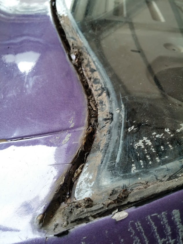

I am anxious to get started, figured the best place would be to see if I could determine the cause of my wet trunk and drivers side foot well. I think I figured out the trunk leak. Right lower window corner, who would have thought right? As for the drivers side foot well, that is going to take a little more digging.
Lots of junk came out from under the trim. Now I need to figure out the best way to take the window out safely.

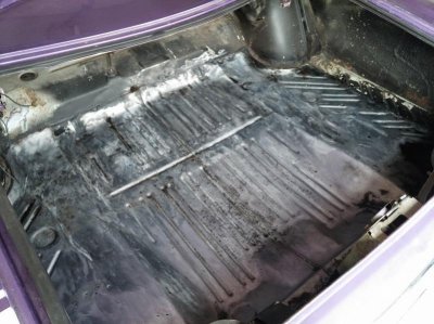

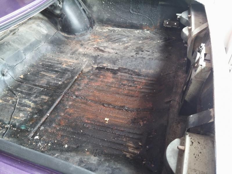

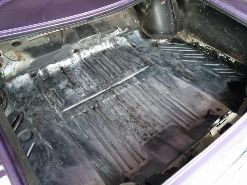

Here is the resulting trunk floor. Looks to have been replaced by previous owner, but the extensions are rotten so I might as well replace this while I'm at it. It'll give me a good chance to learn how to weld too.
Cleaned up "ok" with a couple of hours of dawn dish soap, acetone, 70% IPA, and a wire wheel. All of those cleaning agents were in an attempt to get the WD-40 off of there. In a flash of brilliance about 8 years ago I decided to cover any rust I saw with it. After reading many horror stories about how many problems that stuff can cause on a paint job I hope I didn't set myself up for too much of a headache.

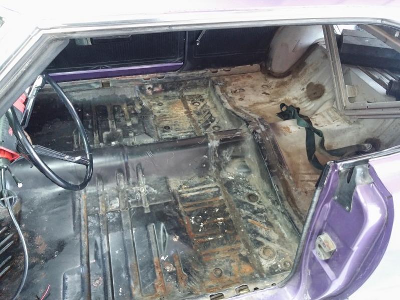

Interior is on its way out too. I think the floor is original, covered up at some point by some rattle can black paint. Rust seems to be very minimal and I think it'll clean up just fine.
drivers side foot well could be blockage in the fender drains from the cowl. the lower part of the fender, just behind the wheel ahead of the door, drains the cowl. most of the time this fills with crud (leaves, dirt, etc.). To clean it run your garden hose into the cowl while rooting up through the drain with a pen or chopstick. Don't use a cut up coat-hanger 'cause you'll scratch up the paint.
