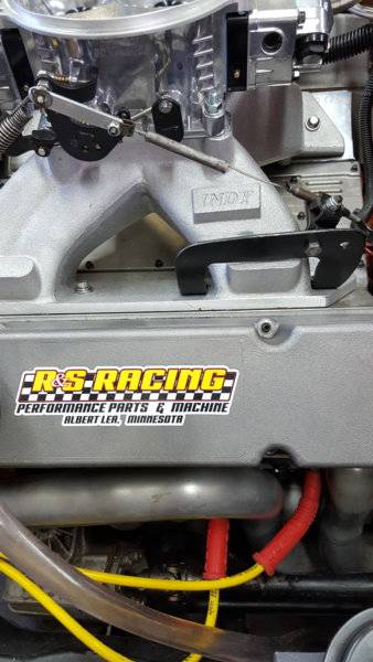

When I put the Victor on my '66 Satellite I got a tall bracket from Mancini but the cable was too short so I made my own tall bracket with cable attaching point located further back toward the firewall & angled it up to account for the added height. Since then modified again to fit the Indy manifold and the Dominator carb. Not a "stock" look, but neither is the rest of the car. LOL

In my case , I made the bracket to be a little lower and angled up toward the throttle body too.
