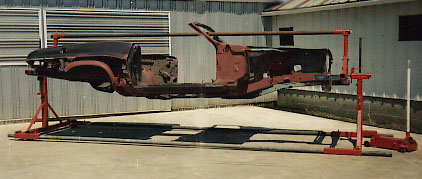

I have a whirly gig and bought it because they made an attachment to stabilize the rotisserie when you put a convert on it
this is a pic from their website
http://whirlyjig.com/
food for thought maybe you can adapt a brace your jig
Interesting pic PD, however, on their website it has no indication what that overhead bar does, and where/how it's attached and to what? I can see fabricating at faux roof for a convertible, to strengthen the entire car. I'm going to X Brace it, in the doors, and on the floor welded on the drive shaft hump, and keep it on the rotisserie for no longer than I need to; about 3 days.
I'll take some pics of my rotisserie tomorrow for you
it's a 2" pipe spanning the the car there is a 2" square tube with a 2.5" pipe welded to the post that slides into the brace on rotisserie
theory is (and we have mounted an e body convert on this fixture)bolt up rotisserie to vehicle using an angle gauge on the end of each post you span the car with 2" pipe plumb the fixtures and lock the pipe using the threaded bosses on 2.5 pipe attached to the up right
that will keep the end pieces from flexing keeping car square too
hope I made it clear
From that pic it looks as if the horizontal top brace is rigidly attached to the piece that bolts to the bumper brackets. In other words it's like adding a roof to the convertible, except the force on this arrangement goes right to the support structure then back to the sub frame and not through the A pillars and other sheet metal. With this setup you must use all the bumper bolts and have that part act as an extension of the sub frame to make it effective. I would think it should have some way to preload the structure too.
