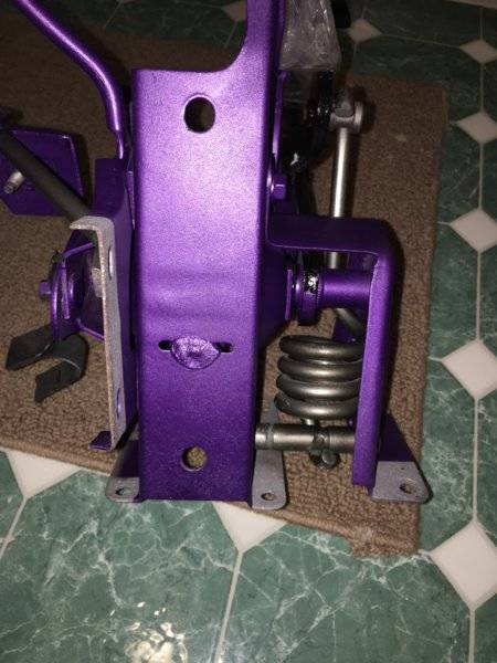

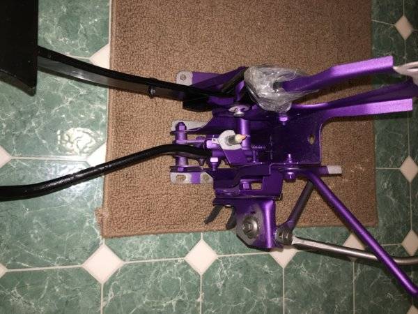

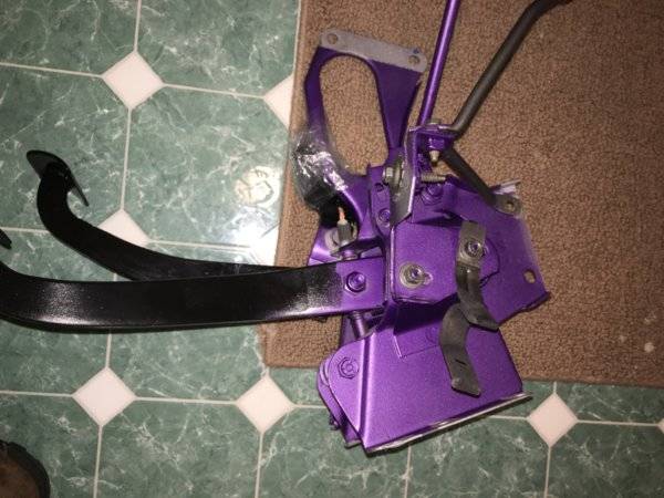

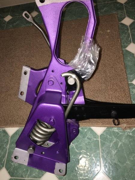

I can’t locate a part number on the 4 speed but here is a couple of photos of exactly what I’m looking for.
Can you send a couple of photos of yours.

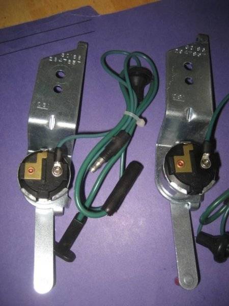

70 has a clutch switch 69-9 will fit but doesn’t have the switch
The clutch pedal will have drilled hole from the factory to allow for a special steel spring and black plastic clip to activate the neutral safety switch ,when the pedal is depressed. One year only parts, specific to the b bodies. Pictured are two switches.
In the second picture (above) of thread#3 ,you can see the spring & clip.
Would you know where i could get 3 of these clutch switches?
