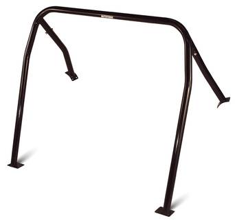

Hello guys, I am looking for a 2 or 4 point roll bar for my 1970 Dodge Charger.
I would prefer the 4 points one, without the bar that links the central arc at the middle. I just want one like the pic below.
If that one is not an option, a simple 2 points bar could be ok too.

Is it for looks or do you plan to race your car? Honestly, a 2-point bar won't do much for you since it will just fold forward/backward if you flip the car (God forbid). I suggest a 4-point minimum.
For the track, the cross bar behind the seats is required + 4-point + a side bar at least on the driver's side (can be swing-out & removable), fyi.
I "think" you can get the main hoop at maybe jegs/summit. Most people will run the back braces along the roof line back through the package tray and into the trunk (strongest).
Jegs has their brand of pre bent roll bars, proster is the name maybe? Just visit their site and punch in your info it’ll come up.

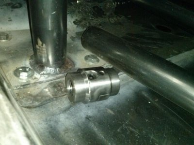

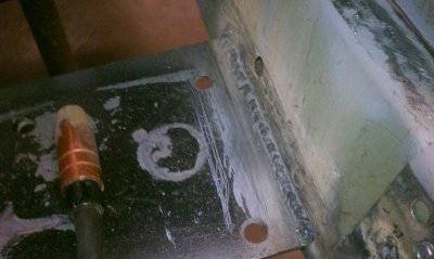

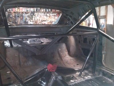

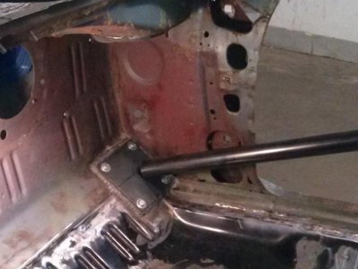

That's the kit I started with and ended up making it a 12pt, but still a roll bar. It is nhra legal and bolts in and out with the help of 4 heavy duty couplers. I welded 3/8" plates under the floors to the sub-frame connectors to rockers and rear frame rails at the rear end hump. Also added door bar to firewall then to shock tower, not shown in these pics.
101884-c81edbd19554f0c8c4a70d523a977563.jpg 97673-e6f399fc9e940677cff018c95d3fbdec.jpg 97355-c30646c13b2c9ffb6e90deef7098bc5c.jpg 99489-ba5553ea430c7e33221e63de7a7d554d.jpg
The main bar was prebent and fit was fine., everything else was easy to add and cut to fit as needed. The only thing I might would do different is buy the prebent rear bars and go thru the package tray to make the rear seat usable. Can't beat the Jegs kit price $186 for an 8pt., and a prebent rear bar kit is $85., then you can use the extra bars to go to the rear spring mnt area.
