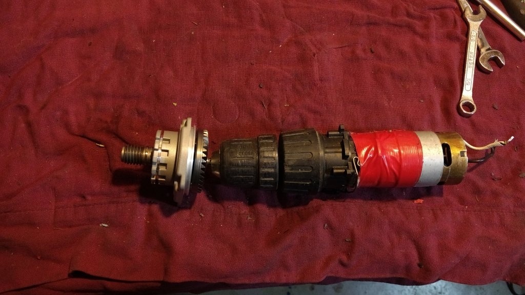

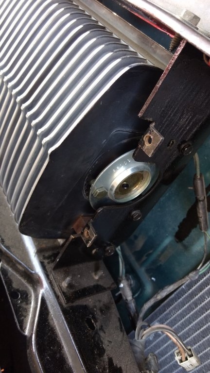

Me too. I gave up looking for factory originals and decided that the motor assemblies need to be serviced and replace with readily available parts. What I'm working with is a pair of Milwaukee 12V cordless drill motors and gearboxes and the angle grinder spindle gearbox, also from Milwaukee.
Here are a couple of pix that might help with the direction of this idea. It's still work in progress and a DIY guy can find components at the hardware store.
