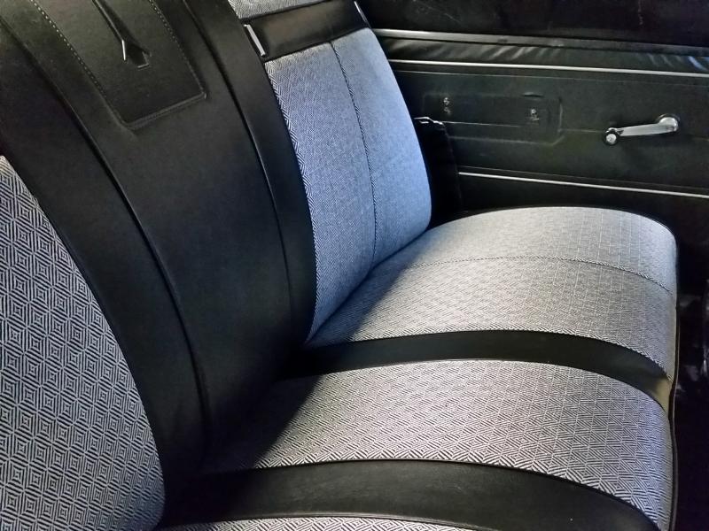

]I agree, definitely give it a shot. Just remember to check your work as you go to ensure that everything is centered correctly so that the pattern on the bottom and back line up. I watched the videos from Legendary Auto Interiors and went at it.
