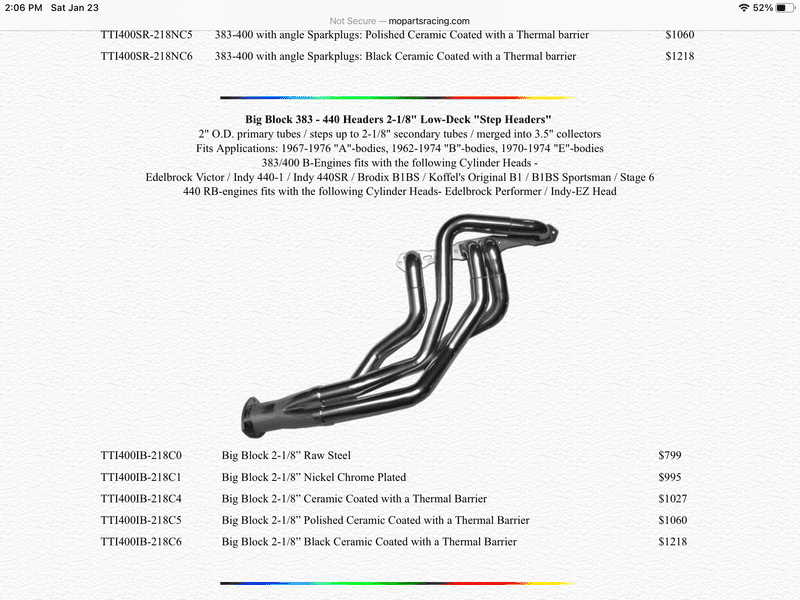

Is this what you bought? Not sure what an Accel Header plug is? Where does that go?
Yes, those are the ones. I believe they are overkill for even my engine since it is only street driven, 496 stroker w 610 crank hp. Header plugs are short spark plugs that will allow just enough room for a spark plug boot to fit on the spark plug. That is why they require ceramic boots, the silicone boots melt and missfire like crazy. The ceramic boots are a little pricey, but definitely worth it. I ended up using 4 straights and 4-90° boots. I had my headers ceramic coated to keep rust down and help a little with underhood heat. I did a grayish silver matte finish. No discoloring, always look good.
